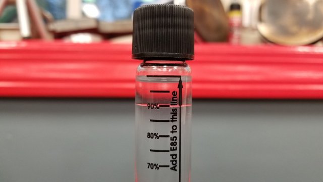

Good corn, not even at the highest it will be yet. Around here it will read above 90% on the test tube once the full "summer blend" hits.
Anything over 80% on the tube is good for 21-22 degrees of timing....

Then this happened @FFBOS
The car picked up the change in less than 90 seconds and reads this as 92-97 % in the log.
Fire corn. I find the test tube to read 5% higher. I’ll do a post here soon when I get a full tank. I had 12 gallons of e70 in the tank. 75 on test tube. Added 6 gallons of e75. 80 on the test tube. Brought me up to 71.7-2% which should be dead on for calculations. I’ll report more.

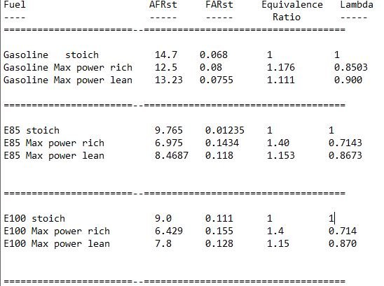

This may be useful info for those that like this kinda stuff
Excellent! Good reference and quick check chart. Helps put perspective on things, esp since I only speak AFR fluently. Taking a pick to save on phone then a copy and paste on computer. Thanks. (y)

Yeah Mike got me away from thinking in terms of AFR last year. Lambda actually makes things a lot more simple.
