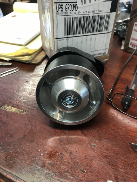

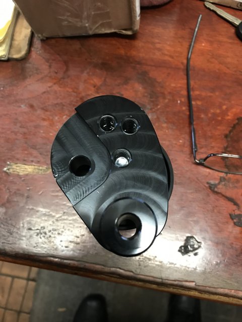

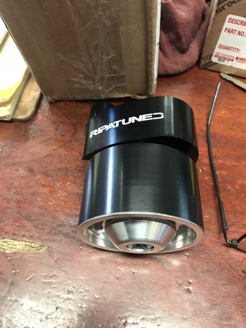

Adjustable tba idler pulley came in today it’s purdy
