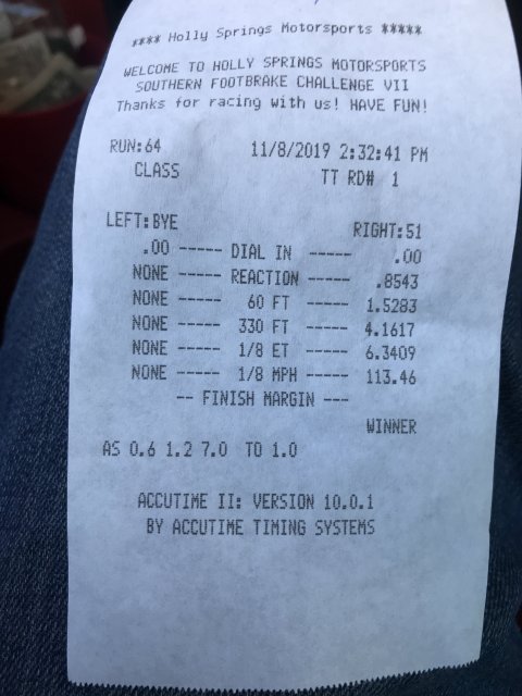

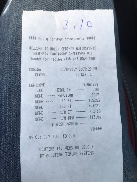

had a crazy day testing in the 1/8 mile today ,,I ran into several issues on the way to the track the airfuel gauge went blank didn't knotice a driving issue but it showed up on the log ,pulled over shut the car off and it went back to normal ,I have no idea whats up with it ,it never acted up on the track but on the way home it did it again ,pulled over restarted car all is well again (I have to research this one may be tune related ),,traction issues with the 2.65 set up it just blew the tires off ( 15 inch conversion will be off season upgrade ),,the 3.10 did very well no traction issue but we had an issue with the trans overrevving going 2nd to 3rd gear called curt he had me disconnect the battery then I went and drove the car around about 5 minutes problem solved !! apparently it lost its adapts (THANKS TO CURT FOR THE SAVE ON THAT ONE ),here the time slips from today we were only able to get passes with the 3.10 set up and I also noticed that when it launched it would have what I would feel lie timing being pulled then it would take off like a rocket ,,after reviewing the logs tonight I found that when launching when it got to 2000 from 3000 rpm timing is being pulled down to negative -1.5 then returns no knock retard in my other logs from before the flex fuel it would only drop to positive 4 degrees .so it was effecting my 60 foot when I looked at the tune around that rpm it set to retard timing but it should go into the negative I think it has something to do with the flex fuel because if I take wot the base which is 93 gas and the alcohol wot and compare the two it works out to retarding 1.5 degrees ,but that may be actually helping my launch ,we were seeing 22 degrees at redline on the shifts and sometimes touching 16 psi but we did run a pb 6.34@113mph which is better then when I was running 17 psi 3 weeks ago .im hoping in no prep tomorrow to get traction and do well racing in the street extreme class 6D28DA46-E663-4221-ADFC-7B196C7C0F45.jpeg 086973C8-FA24-47DE-B312-58C74B10D483.jpeg

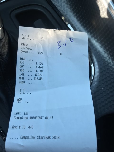

New personal best I changed the tune and fixed the 60ft issue surprisingly it hooked today on no prep
Maybe next pass will help me get a 6.2 time only using the 3.10 pulley E4AC6601-9536-459C-8450-EFEC7A4A9D63.jpeg
Dude I told you picking up someone elses time slip off the ground doesn't count

Lol stop revealing my secrets dammit
I also had a 5 gallons of ethanol in the trunk on that pass I decided extra weight might help today lol

Nice runs!!
At least this time you picked up a slip with a sub 1.5 60'😀

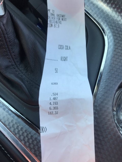

I won the round against a mustang on slicks I spun but stayed in it and drove around him lol 5941EFFD-482A-4BC2-AB42-A029083178A2.jpeg

That’s a .500 light in a pro tree

That B is Rollen !
Must be a hell of a tail wind , lol. :LOL:

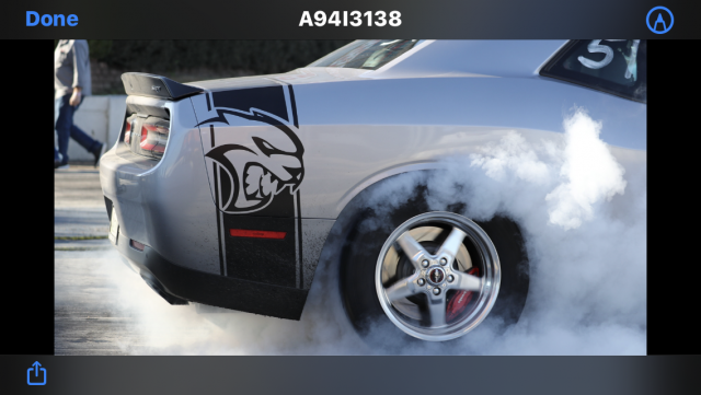

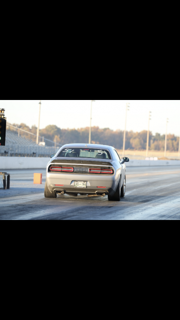

You can see how the car actually gets a little sideways on the launch 84C1DD3C-73AA-4798-9CFD-EA6F3DB424F6.png 943D3C0F-AE19-4F4C-8D93-CA55879AADBA.png
