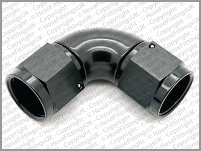

For those that think 90's impact fuel flow in an application like this you need to watch this (or other videos out there showing the same results)
This guy is doing backyard testing.. you really need to do the math..plus my PDF is for bend with a radius.. it changes even more for a 90 degree bend.

His backyard test is just as bright as your PDF file that I read but it’s such minimum difference in fuel pressure that the change would not be noticed or even effective in with Speedy’s baby tune I don’t think he has nothing to worry about😂😂

That's a lot of tight 90's .
When I built the dual 450 pump fuel system in my Monte I used these off the external filter, and before the dual feed/dual cross over rails:
Love me some full flow 90s in that -10 AN PTFE feed line. I believe in maximizing flow potential.
