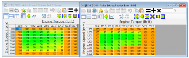

So what does the normal /street mode mapping look like - curious on how much more restrictive it is vs sport !

Interesting, appears there is no diff but the documentation implies there is !

The only differences I know of in sport vs track have to do with trans shifting. It's been a while since I dug through all of that, but in some situations sport shifted harder (up) at WOT and some situations it was track that shifted harder (up). As fumanchu pointed out there are also a bunch of shift pattern tables, so in my tune I have those "normalized" so they all match. When I choose a mode I want consistent results, not ones based on how hard I was on the throttle 15 minutes ago.
There are no throttle settings for the different modes that I've seen. If you know of them let me know where they are.
Later models with electric power steering likely have some changes, mine's mechanical.
The biggest difference I've seen between sport and track are abrupt and unsettlingly hard down shifts in TRACK. I believe SRT meant TRACK as road course, not necessarily drag strip, so the down shifts would be to scrub speed like entering a turn. Those abrupt downshifts bothered me, so I put my mojo in SPORT mode that doesn't have these abrupt down shifts. Mike and I talked about that some years ago and I was surprised by it.
The active exhaust, I'm not even sure what that does at least in a Challenger. They only have modes for "normal" and "sport" nothing for "track' and as far as I can tell the values line up, or at least so close as to not make any difference. I "think" Charger is the same. At any rate as you can see from the tables above, it's 100% above 3,000 RPM anyway.

So I guess I missed something while reading this, Sport mode does not open the active exhaust flaps fully. Does Track mode open them fully?

From what I'm seeing, all modes open exhaust valves fully above 3000 RPM and above a specific torque value of 334.6.

Track mode forces them open 100% of the time (see fumanchu182's charts above).

Where are they 100% in track, I'm missing seeing that.

Post #44, top left of the chart under Active Exhaust ( Track Position = 100%)
From the MasterTech reference book p. 10:
"The Sport setting is more aggressive, and the Track mode locks the valves wide open, which is a place where the Hellcat is very comfortable (Figure 30)."

Thanks! I completely missed that. So now I'm wondering what happens in a custom mode?
