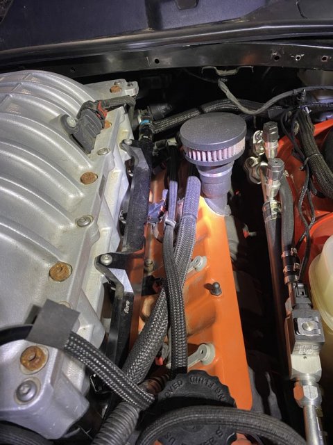

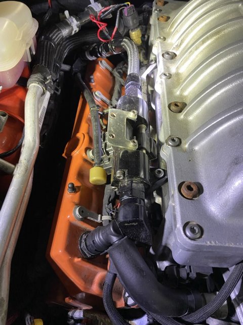

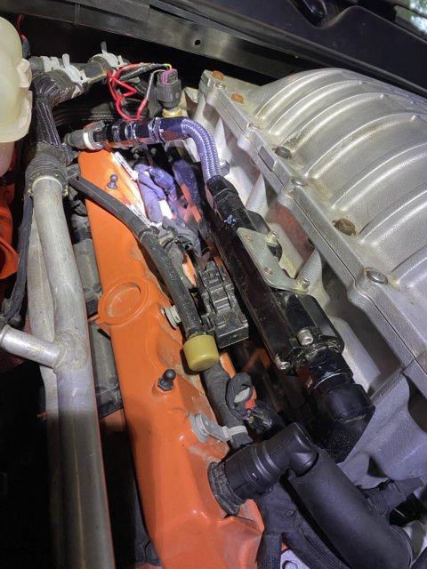

What I hate and might can get around it I already have the rails,and 3 fpcm....I dont need nothing but the triple pumps and wiring
Interesting setup for your sensor. The crossover just goes the the back of each rail? What is the crossover made out of? This custom made or did you buy it?
it was custom made to delete the fuel pressure valve since I was going to put it on the rails itself

Also curious, why did you want the pressure sensor on the end of the rail?
it just seem like the easier place to extend the wire's and as you can still I still had to add...and fuel pressure is fuel pressure. Where is the best place to have it? Before it was the cross over it being at the end of rails still the same pressure I would think. If you any suggestions I'm darn sure open to them. I just ordered the triple pump system from Curt and it may require the pressure sensor somewhere else anyway. The shop that done my dual pumps when they came in the instruction was in the kit and I carried the whole thing to them. So now I can double check and of the wiring or anything else in the installation. To me the wiring just dont make any sense. and I did add the fore rails after the dual pumps. With the dual pumps the were only 2 wire that has to be connected one to the pwm module the other to the relay. It's

It should be fine there, was just curious
