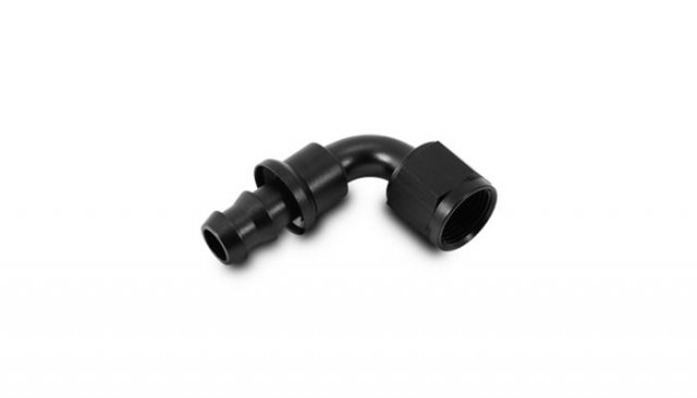

I’ve spent some time a while back looking for pre formed 3/4” hoses to help with routing in tight spots. These are my goto’s but there may be better ones that you can buy and cut up. You can also purchase hose fittings of varying degrees to use to connect around bends and curves. Less likely to leak and easier to service.

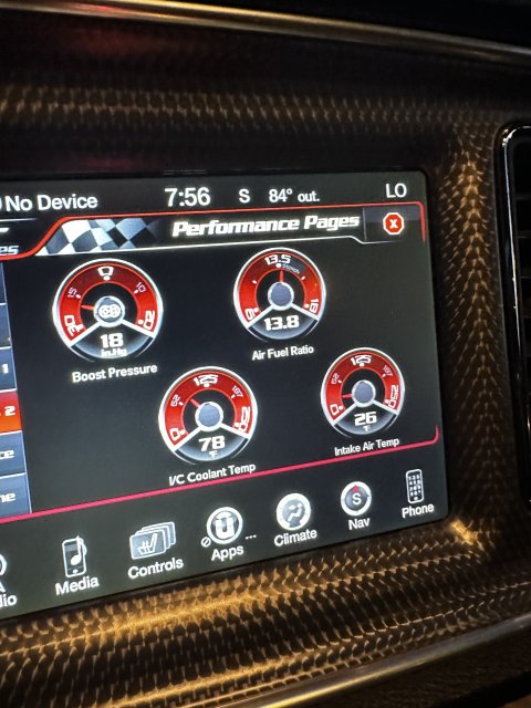

it does. My coolant temp was only at 50 degrees at the end of the pass. MAT 130. Didn’t pull any timing for mat. And I have no aux tank. 90 degrees out. It’s always summer here. Before, the car would pull a few degrees at the top end for IAT. You don’t need it chilling the fluid during the pass, won’t heat it enough during the pass

I ran back to back to back all 9.8 same mph. Chiller works if you do it right (r1234yf). I was a skeptic, not anymore.
