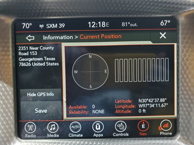

As I was trying to assess why my UConnect clock was off, I discovered that the Nav/GPS location was messed up in my car. Here is what I have found:
- The car thinks I am roughly 27 miles from my real location. Mostly north, and slightly east of my actual location.
- I used the "Current Position" page (inside the navigation screen) to tell me the GPS coordinates that the car think's I am at. I then looked up the GPS coordinates of my current location using Google Maps. The difference was about +.319 degrees latitude and +.096 degrees longitude from reality.
- I confirmed that the map location that the car was showing me was equivalent to it's faulty GPS coordinates. So it does know how to link those still.
- I confirmed that as I drove down my street, the Current Position data was updating/changing. It was not frozen.
I took a picture of the Current Position screen (attached). I do not know what it should look like on a fully working UConnect system. But it appears the only data it could show me were the bad coordinates.
Are the 12 vertical bars supposed to be a "strength of signal" indicator?
What is supposed to be showing in the compass area?
What is "Available: 0"?
Reliability is NONE - Yeah, I got that :p
And back to the clock - it was 8-9 minutes fast, and was set to 'Auto Set' via the GPS feature. I can workaround this just by going with manual settings for now, which I did.
Is there a way to reset/reboot the system?
Thanks!

Looks like you have a bad gps antenna or connection. You have 0 available satellites, for a decent 3d gps lock you want 4+.

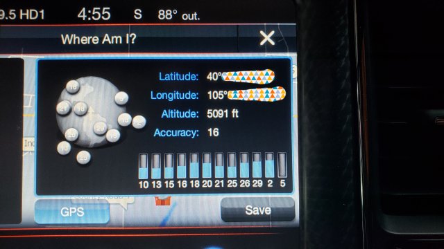

I noticed the clock was off the other day and didn't mess with it, nor check into the position.
I'm not sure I have that same screen or not, now I'm going to go look, just to see what/if, etc. I'll post up what I find if it's worthwhile.
17,310
54,178
My clock has Christine'd itself and the GPS is working normally (I don't know that it was ever out of whack in the first place, other than the clock issue that is (was) similar to yours)

Yes......the verticle bars are an indicator. They indicate how many satellites you are receiving a signal from. In your case there looks to be 0. This is confirmed by where it says "available: 0"

Different screen configuration due to different MY ('16)
17,310
54,178
I was sitting in my garage, so that's why I wiped the GPS coordinates, I don't want any of you stalkers coming after me...
:eek:
Good pic for the visual. That's what I would expect to see for a typical GPS signal display.

I considered doing that myself in my image, but I bravely left the coordinates showing because it was nowhere near my location! :D
It is still puzzling because I do believe it is seeing satelites - the coordinates change as I drive. It just seems like the software is really confused.

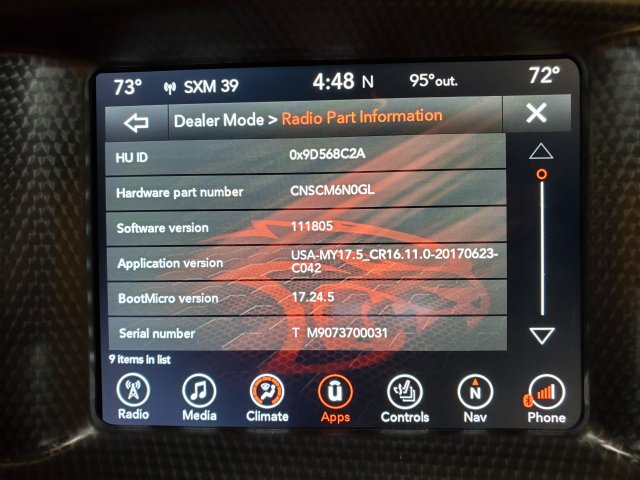

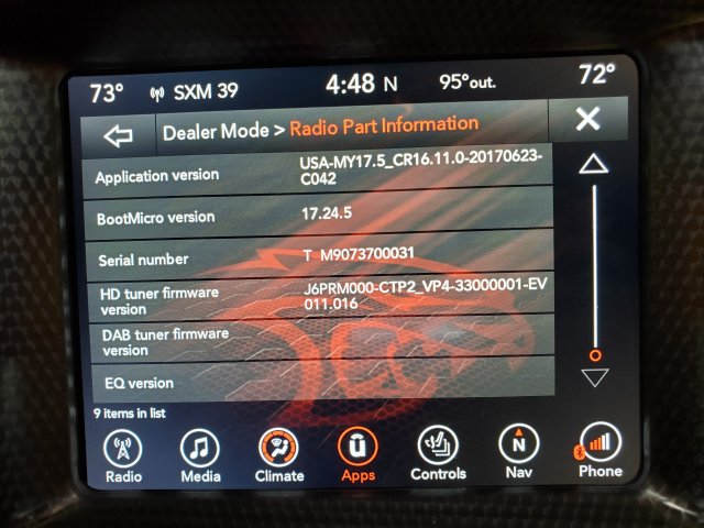

What UConnect version are you running?
Bob
JamesU
#1258
54
73
Austin
2017 Charger Hellcat
Thread Starter #20
I realize this version is older than what some are saying, but UConnect says it is the latest one for my 2017 Charger Hellcat.
