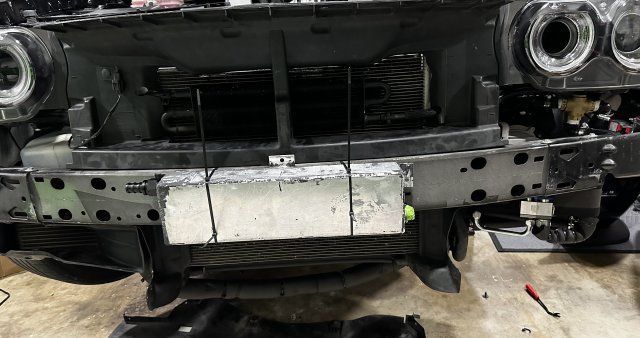

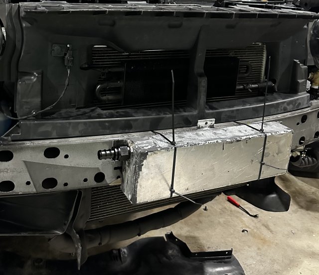

Mocking up a 1.25 gallon custom tank for the chiller. Have a lot of work to do, need to fix several leaks. One of which involves having to cut the aluminum fitting from the brick.
Will be using rivnuts in crash beam to mount tank. New insulation for tank on its way

Mounted with rivnuts, test fit bumper half a dozen times and made adjustments. Now onto redoing the valve and cutting the fitting off the brick

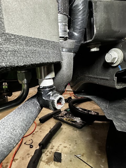

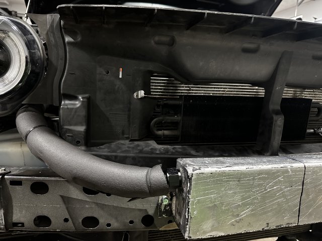

How to remove your old aluminum brick fitting without cracking open the AC line 🪚🫠 dremel with metal cutoff wheel made short work of it

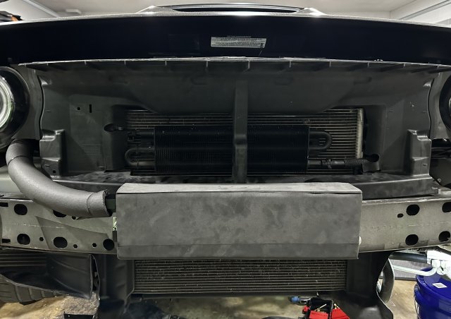

Tank insulated and mounted

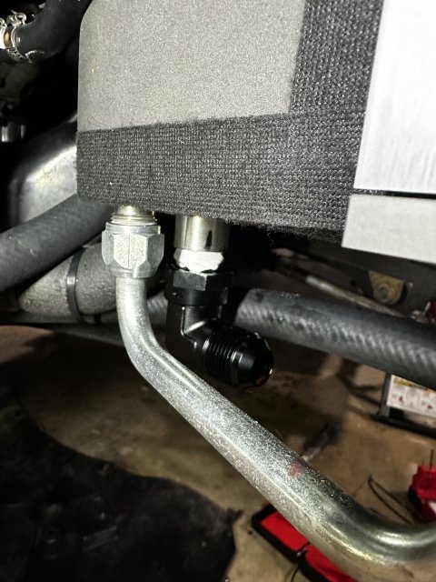

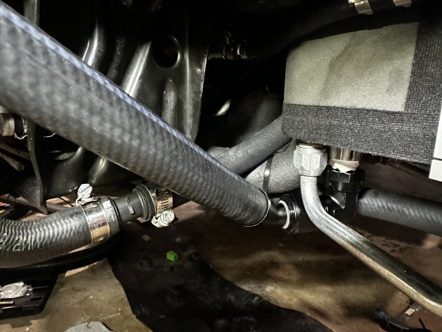

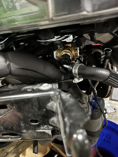

New swivel fitting should work.
5,498
4,529

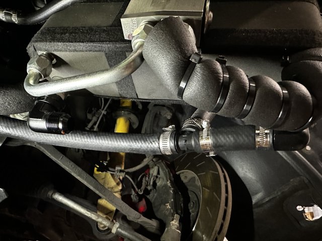

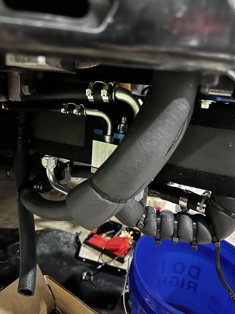

Hoses need to be ran from the top. Plumbing is all good

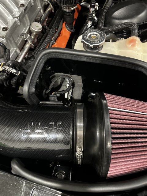

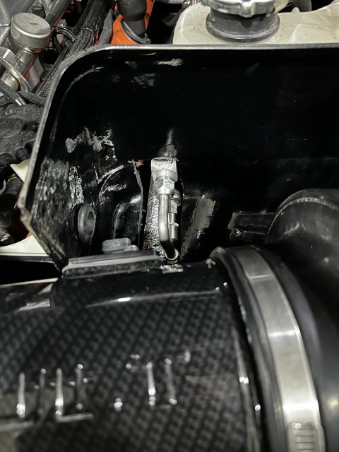

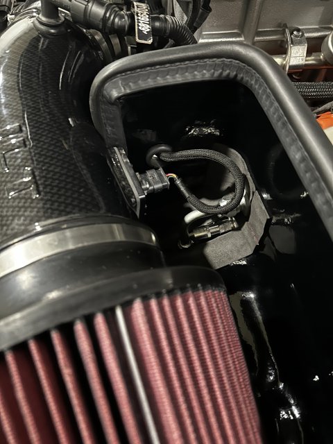

Installed my JLT box, cut a bit to clear chiller lines. Will put some foam tape over it

Takes a bit longer to chill with the 1.25 gallon tank, but not much longer. Fluid stays chilled and you can turn off drag mode and it will stay chilled

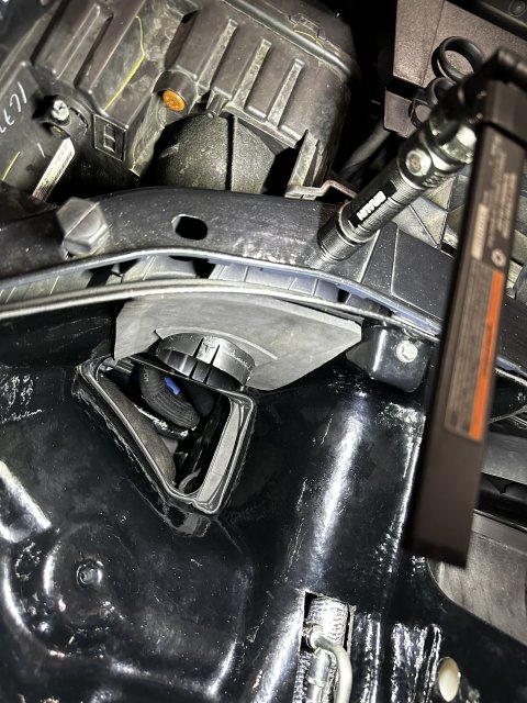

I’m going to make some ducting for where the chiller is to direct air directly to the air box. At idle with no box IATs sitting with no chiller on are ridiculous, radiator fans just flooding it. Having the air box back in should help
