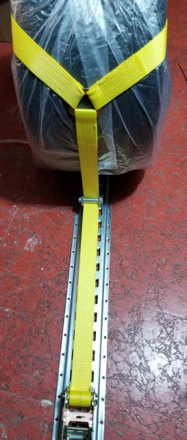

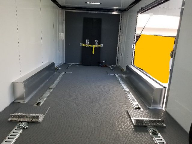

I have an enclosed 24' trailer and use tire nets to secure it to e-trac. I'm not to keen on anchoring the car frame to the trailer, that is hard on the suspension. The open trailer makes for easy loading and tying down. @DGatzby has a great way to to transport his RE on his open trailer with the tire nets setup. But while I was coming back from Road America last year I was caught in a hail storm in Iowa and strong gusty winds and ended up with $30k worth of damage to the trailer and truck. But the car didn't suffer any damage though. The car didn't move around one bit.
