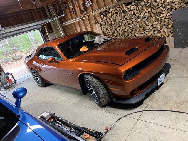

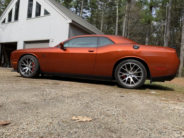

UPDATE:
As I mentioned in the What Did You Do With Your Hellcat Today thread, I finally got the spots out.
Maguires iron remover, water spot remover, clay bar.
I did not use the clay on the glass so there is still some spots visible. Next wash I'll clay the glass.
A lot of effort but it worked without buffing. Very happy! :D

I tried the vinegar, mix, full strength, did nothing. It sure felt like the iron remover and water spot remover were very acidic. Then a quick light clay finished what remained. I did not expect it to work as well as it did. After, I put on Grotts "ceramic" wax.
For the next 2 days, I had water beading up and rolling off my hands! (I did not wear gloves for any of it.) I think I will when I do the 170 next time we the right weather.

Holy wood stack Batman.
What you see it next years indoor stack, the empty space next to it is this years. Then there is the wood in remote shed which holds about 1.5x the indoor.
