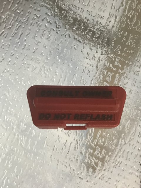

Ok, still on for Monday with NO PCM flash. I’ll get some pictures.

Never ever let them flash your tuned PCM. I even fire a warning shot.
