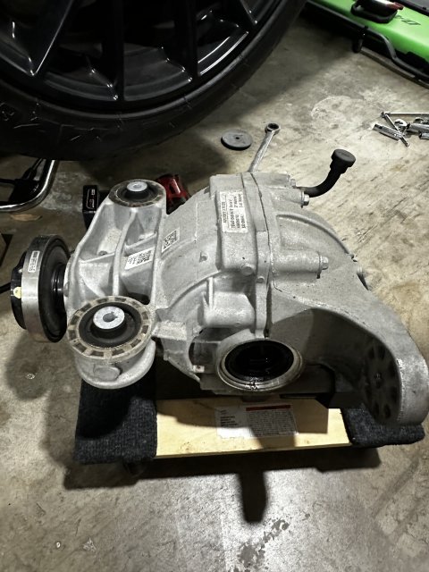

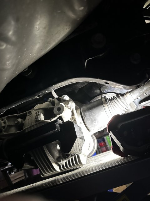

You don’t need to drop the cradle to replace the diff, I literally just did it a few hours ago lol
8,439
7,353
I’ll do it all for you bring it by
8,439
7,353
