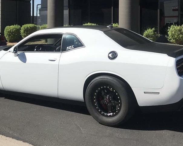

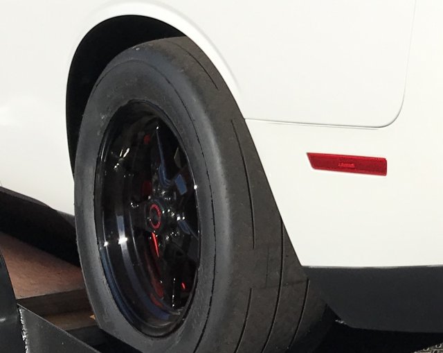

Street tires are never going to get any traction on a drag strip. Best track setup will be a 17x10 wheel with a 6” backspace. You should be able to run a M/T 305 ET-R without needing to do any inner fender well mods. Max tire would be the 315. That one will require some cutting and beating. Here’s one of the 305 vs the 315 IMG_6912.jpeg . IMG_8089.jpeg
