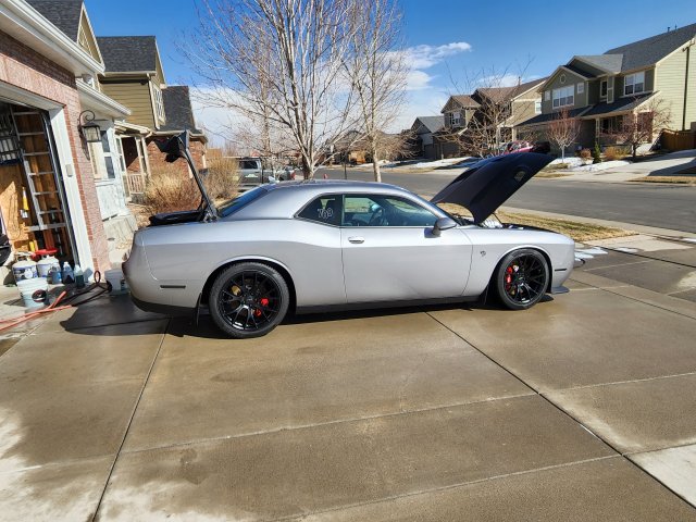

Wasn’t what I was planning on doing today…but I did get to test out my fresh Mickey Thompsons and they felt great - forgot how much quicker the cat is with them! :)
Yeah, no car is real fast with a deck screw tire enhancement...

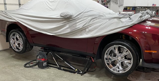

Last couple of weeks. Former champ of the year under the covers.
Oil changed, front sway bar repacked, inner barrels of those wheels need substantial attention - aluminum unprotected, every suspension component checked and cleaned, total underside detail, DIRS and other connection bolts torque verified. Found one piping and brake line connection bracket buried deep up front behind the right heat deflector the dealer needs to put in place. Otherwise other than a quick oil change before my surgery, after they put a new engine in it, I have not been under the car for nearly eight months!! It looks good. It also has new calipers that look pretty, so I made the tires look good. Now on to rebuilding the GiroDisc (Demon Performance) front rotors, then it is ready. Ready for the street as pictured and configured. Change the brakes and add the Triumph wheels and Cup 2’s and she is ready to rumble. That is it. Don’t want to look at it yet, and have not started it since October. It remains on life support, and is in deep sleep. It was able to listen to rock and roll while I have been giving it attention. I may give it another coat of wax in a couple of weeks, go over the interior, but, we will see how things go.
The up to 14” of snow predicted is a little problem, so it will be sitting a while longer.

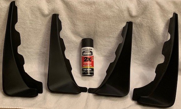

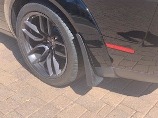

Made new mud flaps for the car. The paint show in the photo is a very close match to the spoiler and matte black trim pieces.

ABS?
What basis did you use for the mold?

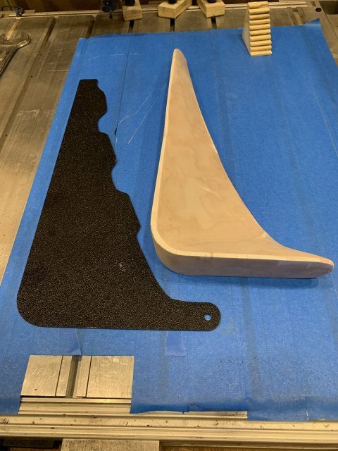

Used 3mm ABS sheet for the base, cut on a cnc. Upper portion is ABS 1.75mm 3d printer filament. No mold was used, but glad to send my computer files (g-code files etc.)

Yes please!
What is the part that looks like a mold immediately to the right of the flat sheet, wood in color?
Did you somehow print ontop of that???
If so, that's a new technique for me, very confusing. Maybe I'm missing something.

The part you are looking at is the printed part itself. The surface finish of a printed part is usually banded and so to get a good finish, I cover the part with a skim coat of bondo (giving it the light brown color) and sand it smooth. That's what you are seeing in the picture. Then the printed part is glued with epoxy to the abs base and the whole thing is again coated with bondo to hide the seams and is sanded smooth for paint. I've included the base flaps as pdf files, however the printed portions are .stl files and this site won't let me upload them. It takes a lot of work to make these, but I am glad to help anyway I can. Do you have an email address that will allow me to attach the needed files? If so drop me a line in my inbox and I'll see what I can do.
