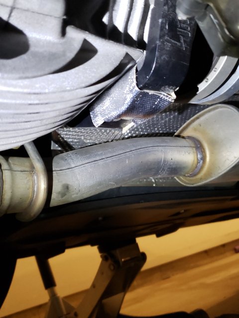

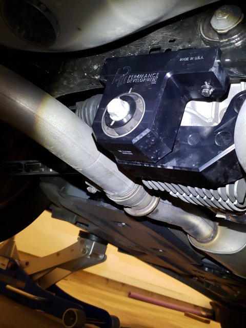

Put my rear braces back on. What I found last year with the front one, there is a rubber piece that goes between the brace and rear and it started to come out. So I used some heat barrier tape and wrapped it around the brace to keep the rubber in place. Also had to notch it for the aluminum flash on the snout

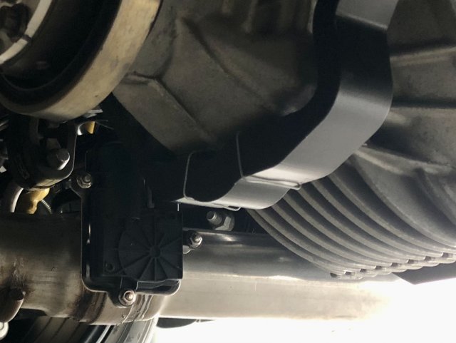

Safety wired mine per the instructions. The pad still has moved towards the rear just a bit still.

Maybe investigate a vulcanized solution for the two posts above???
