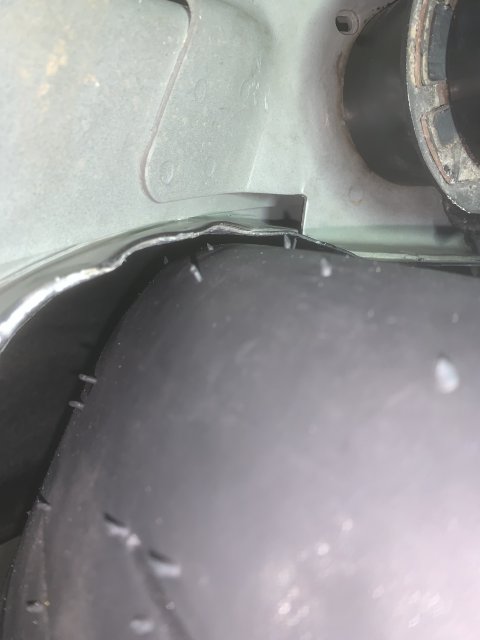

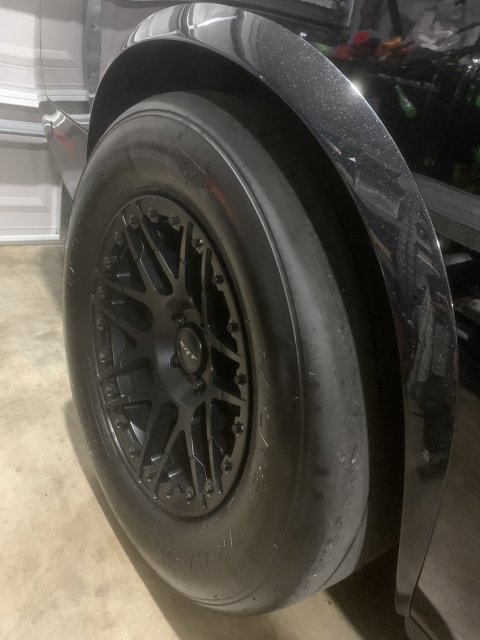

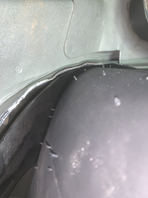

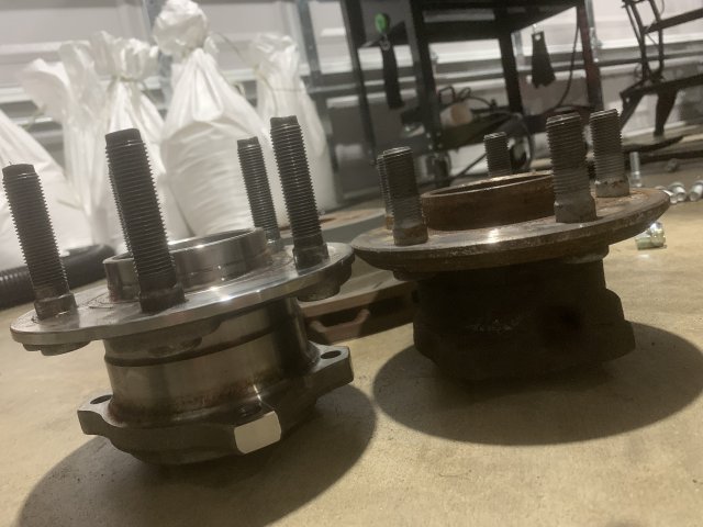

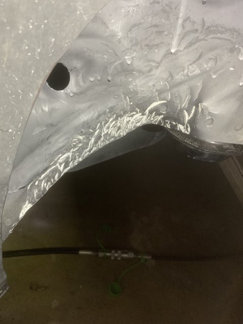

Yep, I took the sledgehammer and they still were too close for comfort. I got
some 1” longer wheel studs and custom gun centric 18mm spacers and put the Phillips performance flares on

I wouldnt think the challengers and chargers would be much different but they could be. I have the same wheels and mine just took a little hammering. There is a write up in the wheels section I did on mine

Yeah, it’s that bottom lip where it turns to an L in the fender well that sticks out. I got it to clear but that was with stock camber, if I ever get arms on the back I don’t think they’d clear. Just some piece of mind

I did the arms first then this. I would have to look where everything sits on the ground but being close to the middle it may not matter. If the tire is higher then after the camber adjustment there would be even more room

We discussed what you did but elected to massage the inner fender well enough to clear the tire.

I got it to clear with sledge hammer but with the tire aired down I wanted extra assurance

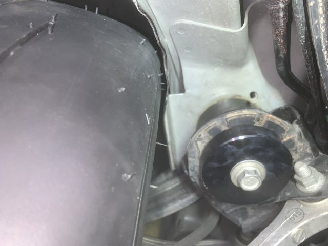

Plus I had wheel weights on the inside of the 1 wheel and even with shorter rear sway bar end link it hit the one weight, so I moved it in anyway but now don’t have to worry about it. Have everything I need to fit any tire/wheel combo in the rear now

Make sure you zip tie all of your wires so they don't hit.

I double checked them and surprisingly they looked well secured and out of the way, I’ll have to pull the wheels and zip tie everything garage is still a mess from getting ready last Sunday lol
