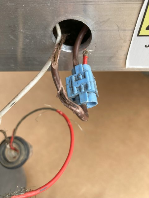

Took it to Street Night Wed, signals, brake lights and brakes worked fine. On the way home, the running lights didn’t work! It was dusk, only 20mi, made it home without getting pulled over.
Stupid mfr has an opening at the end of the longitudinal frame tubes perfect for a mouse to enter and make a home. And they found the wire insulation to be very tasty! Spent most of today flushing and vacuuming out mouse nests, making covers for the openings, and ripping out old wire. It looks like only the running lights are affected, they shorted and blew the fuse.
I now need to run new wires for the running lights, this time in plastic conduit and routed under the deck instead of inside the tubes. (All the original wiring that was not in the tubes was fine. Apparently mice only eat wires inside their house!
One more afternoon and it’ll be better than new!
BTW: I sprayed Kroil into the frame tubes hoping it will discourage potential new residents until I can repair and reinstall the running lights.

On the positive side (no pun intended) that's the perfect opportunity to get rid of those damn connectors.
I'd rather deal with rodents than those dumb things.
They really are one of the worst styles of union.

When I worked in industry, all EE's I worked with had the same rule: NO IDC (Insulation Displacement Connectors) ANYWHERE! (Let alone in an exterior automotive environment! (It will get it through the 1-year warranty though!)
Here is my method of connecting the lights. 16awg wire in conduit epoxied to the light. I'll use adhesive lined shrink tube at the splices. Adding sealant when necessary. Ground terminals will be coated with Fluid Film. This should outlive me!
