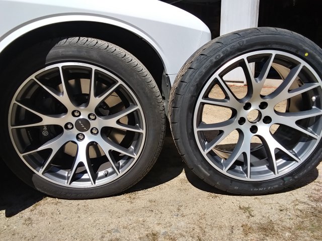

Here is what I have on both cars with 305's, except this paint config is apparently no longer available in 10.5. The pockets were black and I repainted them to gray.
https://factoryreproductions.com/pr...lcat-replica-wheels-gloss-black-machine-face/
Some of the other "slingshot" wheels are available in 10.5. I am very happy with them. You can always have a wheel repair shop refinish the wheels to match your wheels. Here is the 10.5" FR next to the OEM.
6,905
12,835
That looks really nice, 2nd.
I should probably paint my black ones gray, then sand off the paint from the spokes.
