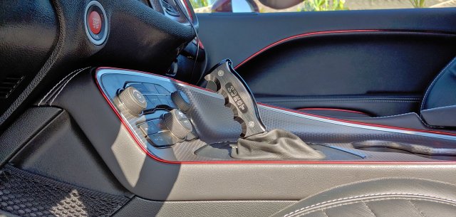

I installed this on my A-8 and its pretty cool i bought it used from a member on the forum Mark W and the install was rather easy 20200227_151731_HDR.jpg

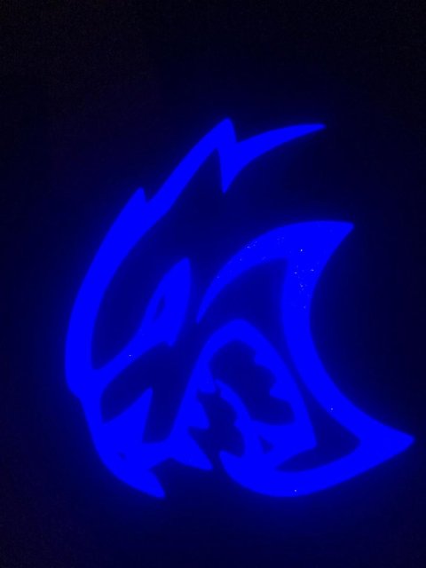

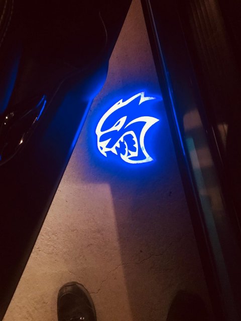

Added blue puddle lights. I got these on E-bay for $36 and thought they'd look cool with my B5 paint. The 1st pic is with the lights on in the garage. The second pic shows the clarity of the image projected in the dark, but for some reason I couldn't capture the true color at that distance (tried like 10 x's). The 3rd pic shows the true color of the image but I could only capture it at close range below the door (that's why its blurry). In real life, in the dark, it's that striking blue with crystal clarity of second pic. (pretty dramatic, imho) In daylight there's no real image unless your looking for it. For $36 and a few minutes time I thought it added a little something.

NICE ! i saw these on the internet and was wondering if they were as good as they advertised.. looks good

Nice. The clarity looks great! Nicely done cool.

I got them cheap direct from China. Took 3+ weeks so if there's anything on or in them it should be dead by now. I thought the same as you but said "eh, for $36 I'll take a shot" plus they were the only ones who had blue. I'm glad I did.

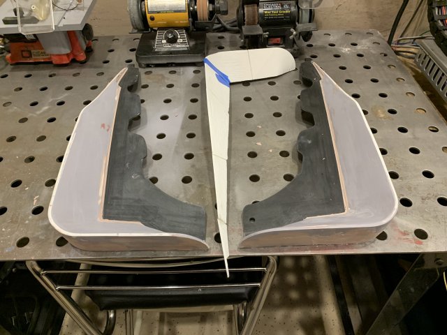

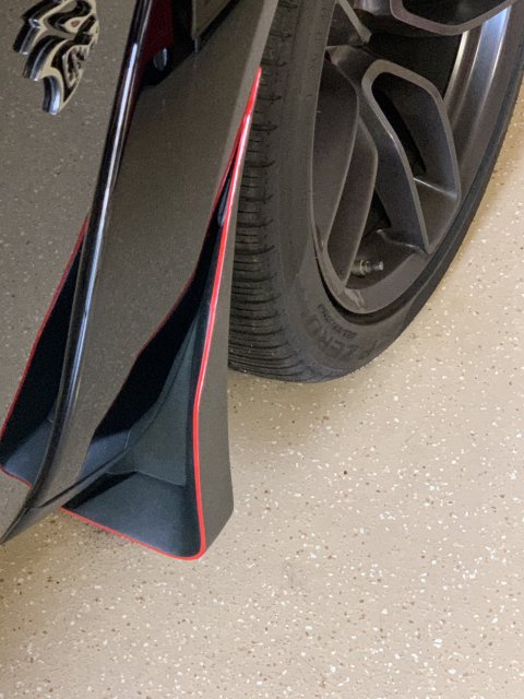

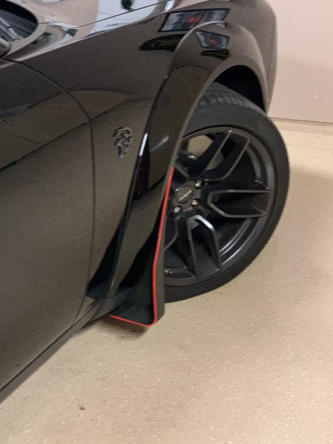

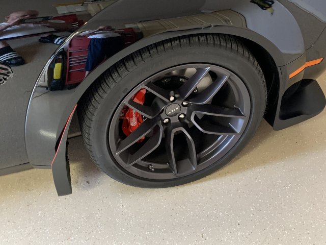

New Mud Flaps.....I've been working on making mud flaps or rock guards or whatever they might be called. I tried the ZL1 flaps and they were too narrow for my taste and I didn't think they protected my car, so I cut new ones about an inch wider on my CNC. Because the only thing I can't leave alone in "good enough" added some aero cosmetic stuff to the newly cut flaps and tried to match the front spoiler. Any comments, are appreciated.....

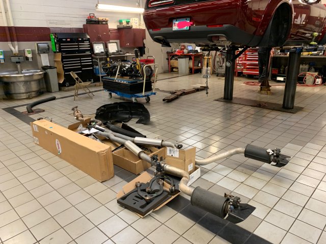

LOTS! Does it count if someone else is doing it for you?
Tomorrow: lessons in alignment!

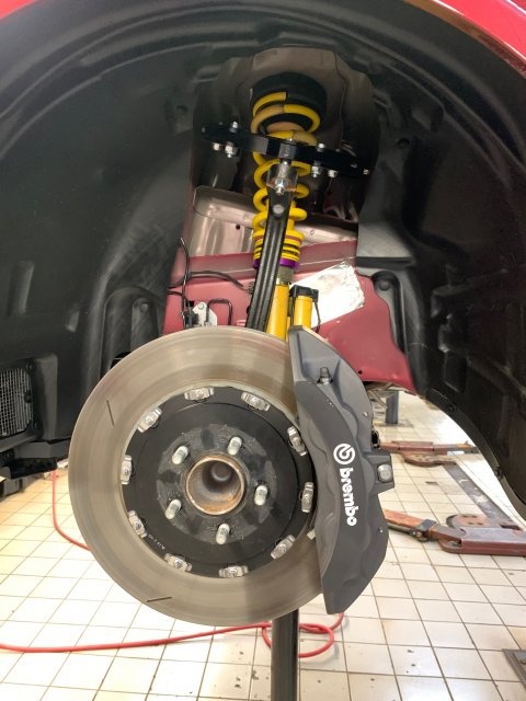

Hell yes it counts, I’m interested in hearing your opinion once it’s done. Thanks John
I know I liked the items I bolted on already when I drove it two weeks ago.
Front Petty Brace
Front BMR 1.75" sway bar
Rear Tension Rods
Rear short solid sway bar links
I'll have a complete report week from Saturday unless they close the roads
to the track in Hallett, OK. Just those tension rod bushings helped the hop a bit. I really did not try much, but leaned on it once and it seemed to sound like smooth "frictional losses" happening with the expensive 345/30's!
The front was massively more tight lacking the lean it came with. Those progressively stiffer KW springs should finish that crap off.

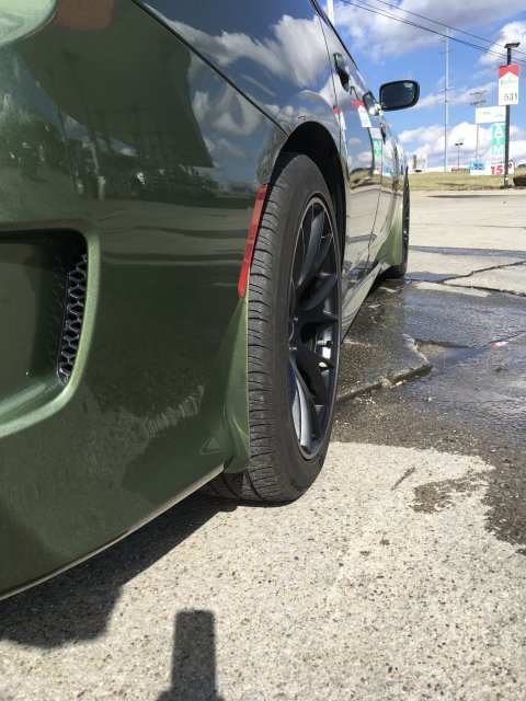

Got the ZL1 rock guards on (really got a pic finally, put on a few months ago). Color matched so they blend in a bit better (not a problem for those with black cars, I guess).

Looks good, nice job!

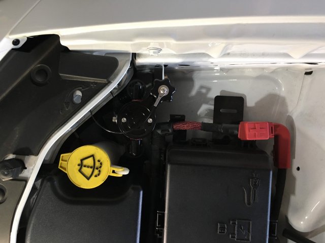

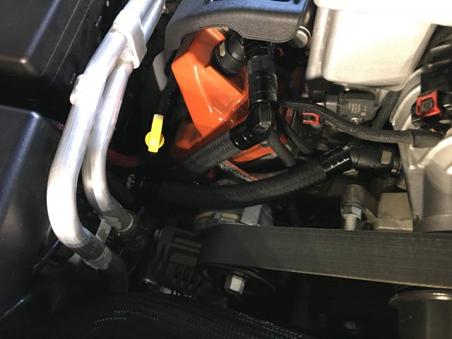

Completed the second oil and oil filter change on my cat. Enjoyed how simple and quick it was as I previously installed the oilcooleraccess.com door for the oil cooler drain and Stahlbus valves on both the pan and oil cooler drains.
I also installed a UPR fender mount catch can with check valve. Easy install and looks nice. Looking forward to seeing how much oil I catch in it.
