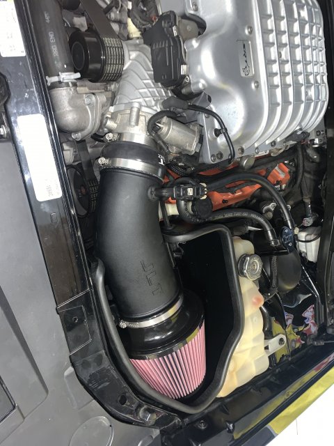

Performed a magic trick and made my stock intake disappear and a JLT appear in its place.
This thing is loud as hell now, no complaints. Can hear it screaming, made a few heads turn on the strip. Obligatory post of Max, cause he’s a good puppers.

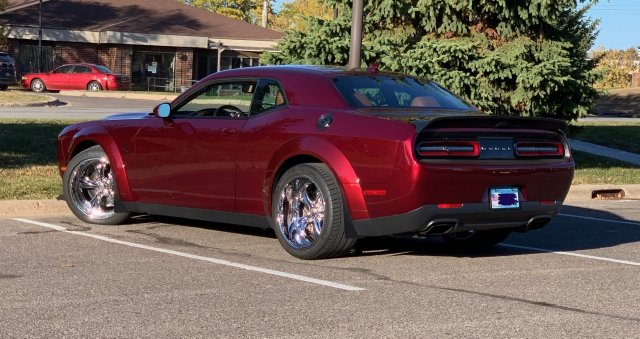

Fine tuned/alignment in the rear. Got the AAD stuff pointing forward, nearly flat camber. Then picked up some dinner, it looks better now. The lower and lower the sun gets, the better this Octane Red looks!

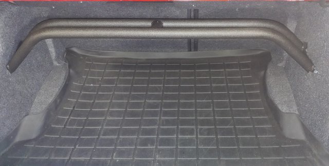

Did this.
Yes, bragging.
At 6'-6" tall, this ain't easy (for me).
Thanks to @Mean Cat for giving me all the info for a clean install!

Nicely done. Taking the extra time not to hack up the trunk liner makes for a really clean install.

Would have made install SO MUCH EASIER!

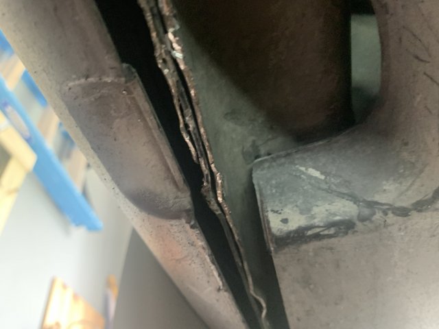

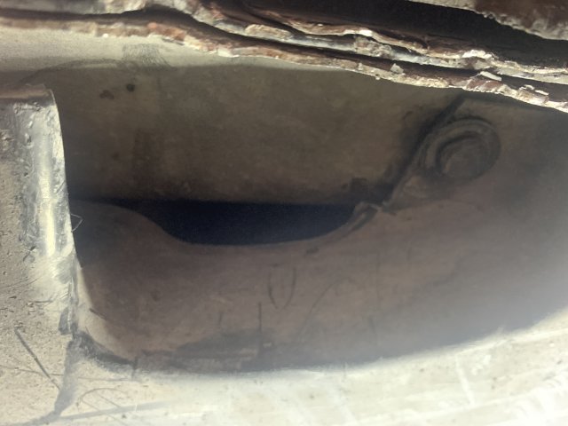

Repaired the pinch weld do to the damage done jacking like a rabbit at the track to put front skinnies on. Then added some lift pads as I don't want to have to deal with the sound of metal breaking/bending ever again while on a jack and having a mini heart attack because of the pops.
Straightened out the pinch weld, it was all fuckered...
Trimmed some plastic so it fit.
Loctite cause fuck you backing out set screws, that's why...
Admire your handy work...
Test.
Should have done this right away when I got the car but now it's good to go. No problems at the track anymore and won't have problems at the house either. best part, can be used with jackstands now as the load is distributed.
