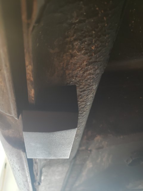

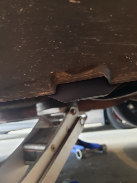

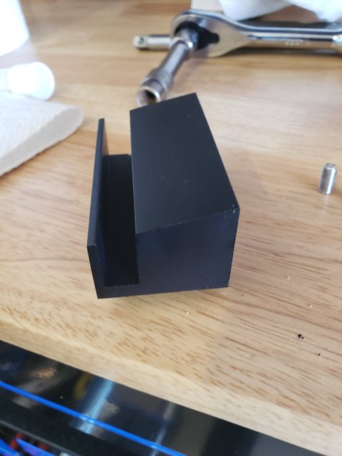

Put the front lift/jacking pads on the challenger. I have had them on my charger for 6 years and it is one best mods if you are jacking the car up a lot like changing tires or oil changes. Much easier to get to then going to the frame. Put lock tight on the screws. Almost lost the ones on the charger for not doing that. Should have done this years ago. I got a set for dads T/A at Christmas. These came from Amazon and fit perfect. $28
