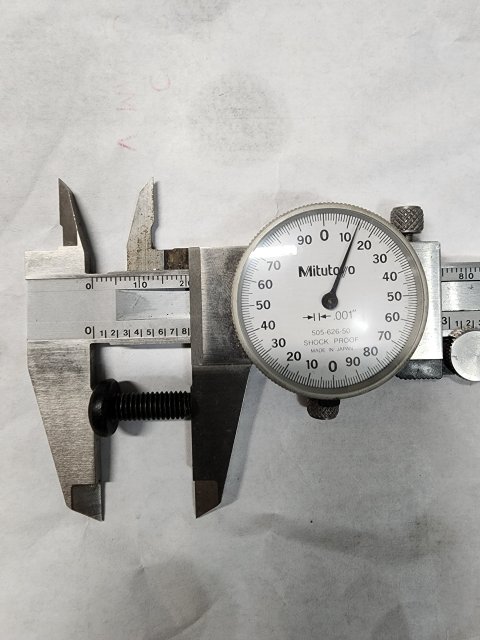

Looks like what I have are T30 head, M6x1.0 thread. I checked them with the thread guages in my tap/die set.
Threaded part of screw measure out to slightly over 16mm. I checked it with the depth gauge part of the calipers but couldn't hold it all and take the pic at the same time.
OAL of screw measures out to almost 21mm
