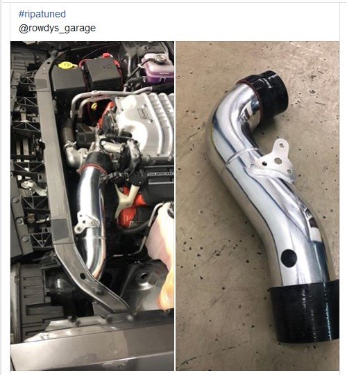

This popped up in my faceballs feed this morning.
I wonder how much they are going to charge for a tube? Note that is a 4" pipe fed by a sub-3" hole in the headlight, which will restrict the volume. I find it funny that the vendor even mentions using a velocity stack/bellmouth in the comments (almost like they are trolling the forums reading my posts. #humblebrag). I'll still maintain my position that an intake tube into fully a sealed box is the best overall option for all pre-2019 Challengers and all Chargers - especially considering not one vendor has shown definitive (and independant) proof that their product is superior to stock, or at least superior enough to substantiate the cost beyond NVH generation.
FYI, you can build this off of eBay for $50 in parts. But, folks are so quick to throw their money at the next big thing...
So that thing just draws air from the little headlight hole with no filter? Might as well just use the black key. [facepalm]
Funny ..... I already tried something like that . First time going WOT the car shut off and got a code . It was one of the barometric pressure codes . Basically not enough air volume and the ecu seen the difference and shut the motor down . .......
