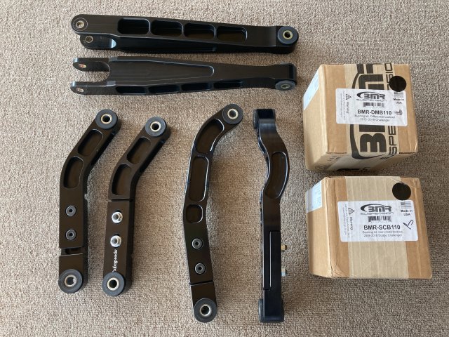

SCB110 lockout kit $249.99 from BMR. easy ,easy, one side at a time ,you don`t have to drop the whole cradle like they say.
@oilburner
You take the exhaust off or just lower it out back too?
I have all this sitting waiting to install but don’t want to open a can of worms, I’m just not up for such atm, Had to many of late.
Unfortunately I work with floor jacks and jack Stands. What’s the estimated start to end time to install all this in one shot? I’m pretty mechanically inclined and have a plethora of tools at hand. Thinking of doing it today, like starting now

I would do your lock out kit first an no you don`t need to drop exhaust. start on one side first, I started at R.F. corner of cradle an if you need more drop back off R.R. corner . hardest part is removing that odd shape safety wafer they put there. once you have done both on right side torque your bolts before you move over to left side ,that way there`s less chance of misaligning the whole cradle.I would do these first then take it for a ride to feel the diff. the arms are more involved but no need to remove exh.
when you do the arms remove the camber arm first then the upper forward arm , do the lower trailing arm last. install uppers with lower still in place .
they sent with stock length tabs in place. lay the new arms over top of stock arms an you can confirm yours are set at stock length.

follow their instruction`s for removing those safety wafer`s an trimming rubber on stock mount`s.
make sure those rings are seated all the way ,I lubed them so they would fit over easy .

Thanks guys, in process now. I lowered the exhaust already, and the whole cradle 4-5”. Doing it all in one shot

just looked again at the parts picture an see you have speedlogic arms without the tabs for adjustment. hope its all going smooth for you.
Done, from this
To this
The Speedlogix ones use serrations, each click is .030”. I set them 2 clicks out from matching the OEM arms.
6F6AB759-C6F6-47A7-82A7-48F43B5F86E0.jpeg EED06050-8C61-4C52-9B3B-8D069A5AB8A5.jpeg
Installing the 6 arms was a breeze, the Diff Lock Out kit was the time consumer. Could do a second one in about 2/3 the time this took after knowing how it’s done now. It’s ready for a test blast.

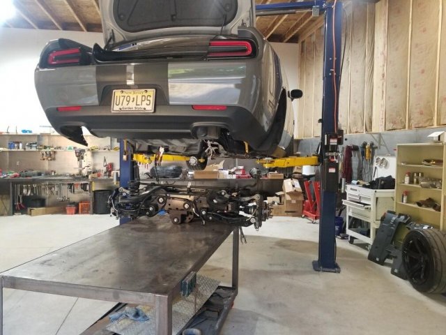

We just finished installing the AAD drag pack kit( https://aadperformance.com/collections/dodge-charger/products/drag-pack), and the BMR cradle lockout on my car. Went over and got it aligned. The guys at aad talked to my alignment shop about setting it up.
Here are some pics:
Before
dropping cradle out of the car
Detail of all components, particularly the 4 cradle mounts, notice the bushings
After-
assembly complete
detail photo
Isotators inserted into 2 of the bushings
Wheelwell view
Sean

@16GoManGoHC2 man be careful with SpeedLogix parts. They have a history of being inferior and have issues. Don't wanna surprise at launch and wot.

Nice :( I got rid of BMR stuff after seeing some of it break and thought I was upgrading to these. They look and feel like quality parts, they’re adjusting and lock up method looks sound as long as the bolts don’t come loose. I replaced the lock up hardware with grade 12.9 high quality stuff. Damn, now you’ve got me concerned again :(
#76
I have a set on my car ..... And a set on my old car . No issues what so ever. I wouldn't have sold them if they were junk or bought another set for that matter .
All good, there better then the BMR and for the price unbeatable!!
