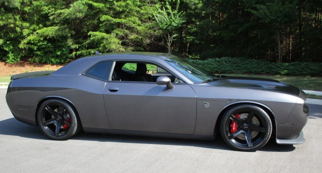

Need an option for "other". Mine has been lowered and all suspension components replaced.
