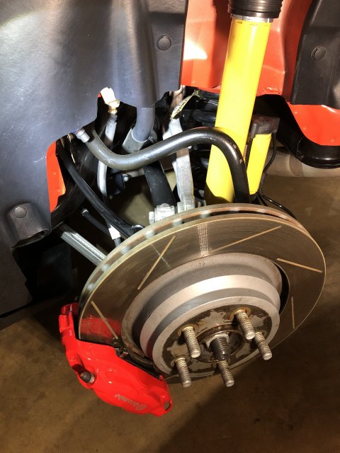

I think I found the stud that will work for my needs. From left to right is Doorman stock replacement 610-502 at 50 mm stud length
Doorman 610-435 with is about 8 mm longer then stock
Doorman 610-509 which is about 25 mm longer then stock
And ARP stud which is about 45 mm longer then stock but knurl pilot is not present
Going to be using the 610-435

Thanks @Hpindy ! Correct me if I'm wrong, those Arp studs are listed 0.50 " longer than our OEM one's but with the ball nose, they are 1.00" longer over all?
I would have to measure them . But that sounds about right . I have them on my car .

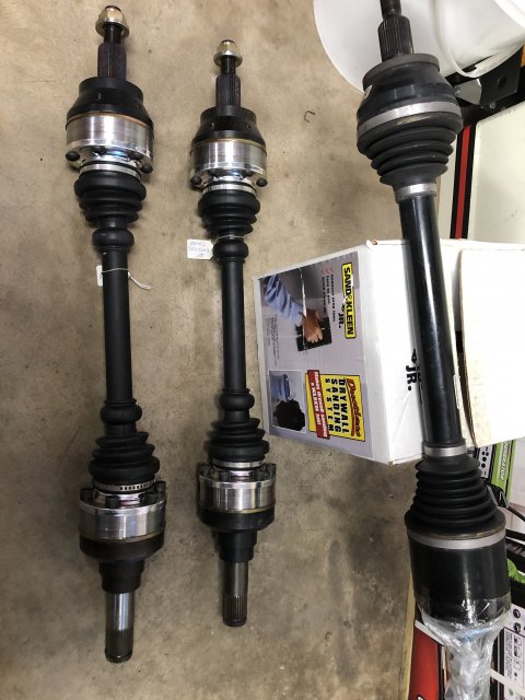

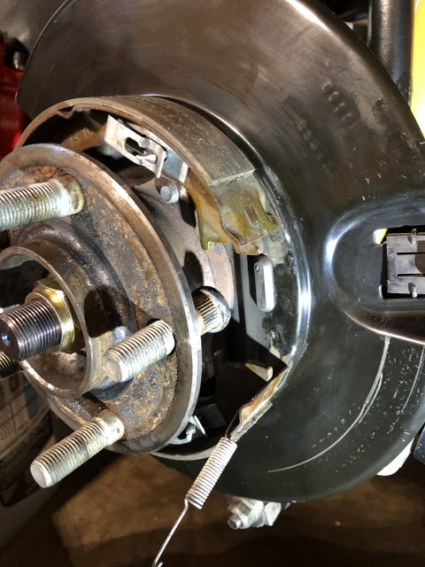

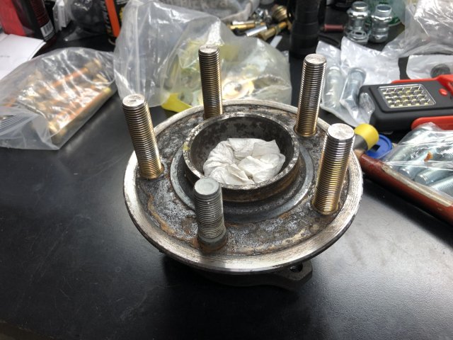

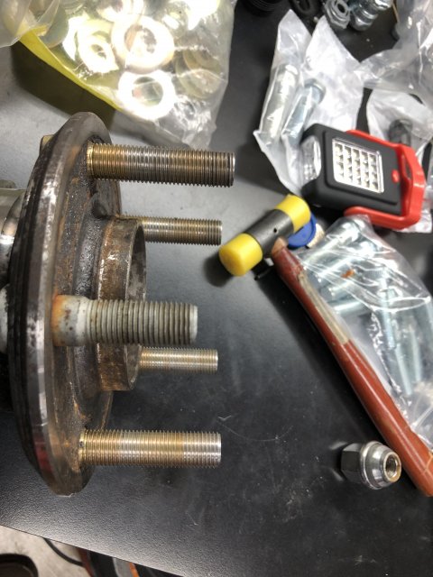

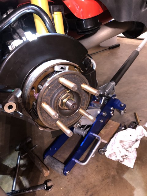

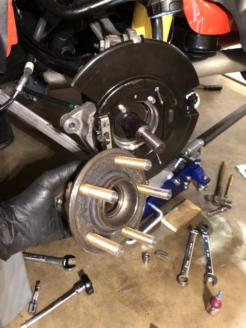

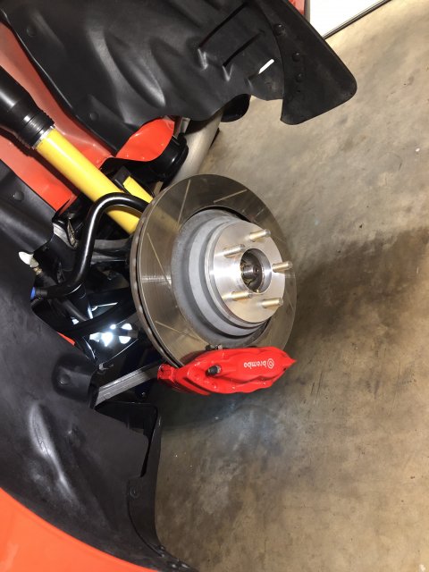

Installed new DSS Stage 5 axles yesterday along with changing the studs. They don’t come out without removing the hub as some have suggested. Also, the Bolt heads that hold the hub on have a goofy head on them requiring a special E12 socket. The harbor freight ball joint splitter worked GREAT getting the old studs out, recommend tool for $20 it worked great. I ended up using the ARP studs cut to 64 mm under the head which gave me full engagement using a 12 mm spacer on the Racestars and when putting the stock 20’s back on without the spacer original lug nuts had 2 turns left before bottoming.
What a job the first one was, since hub was off puled the E brake shoes off to cleaning things up and learned the hard way the lower alum shoe retaining pin has to go back in BEFORE putting the plate and hub back on, there’s no getting it in after assembly like the top one :(
But now ready for testing :)

You are correct on the removal/installation of the studs on the rear . I had a brain fart when I posted above . The method I mentioned above only works on the front . I apologize on the miss information. .

No problem no harm intended just setting the record straight for those that think this is a easy task, it’s not unfortunately

You got a steal of a deal there, took me all day (well, one I had to do twice because of that damn pin) Passenger side took half the time once I did it twice on the driver side lol

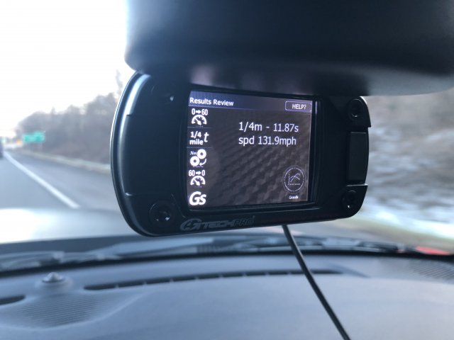

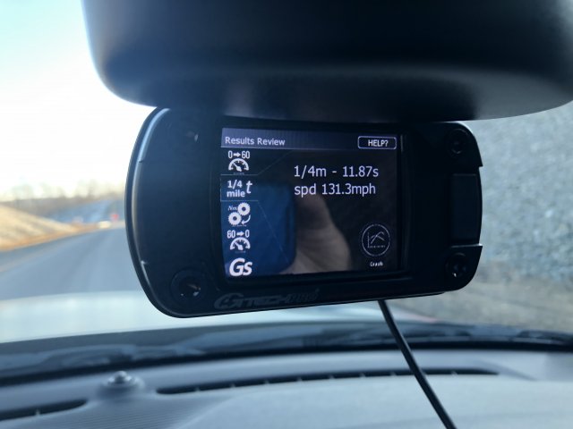

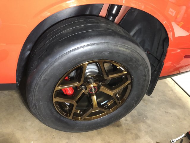

Ok, so 52F here yesterday, local test area, concrete bridge over the river, warmed up to a balmy 42F surface temp. Did a 1st gear hit, pulled over checked stud torque ok, no rub, took it up to 140 slowly felt good, went back to the starting gate for a full hit. Unfortunately spin spin spin, felt no different then the Nitto NT05r, couldn’t hook, too cold. Max G’s on launch .76, .78 and .80, high 11 1/4’s 2.162 60’. Went home and put the Nittos back on and see how they did within 1/2 hour of the 3 passes I tried. Launch G’s .80, .82 high 11 passes and about the same 60’. Even though 50 out it’s been 10-20 for a few days roads just too cold. Funny thing ran a 11.87 on the MT’s and a exact 11.87 on the Nitto’s. It’s going to be a long winter waiting on spring for the track to open :)
So at the moment the Nitto’s and the MT’s dead even on street hook on a 42F surface.

Maybe you gotta play with air pressure? or compound on M/T's just has to be warmer to be more effective than nitto's ? Hope so, that's a lot of money and effort for no difference.

Also why are u using an external performance device thingy. Is it more accurate than the one incorporated in the car's computer?
3,686
8,693
Thread Starter #55
Yea, I like the G-Tech, it uses a 50 Hz GPS unit and is very accurate, I’ve compared it to track timers numerous times and it’s within a few thousandth’s of hard wired sensors. It gives 60’ times and can graphs runs side by side and incorporate G forces into the run so you can see where your loosing time etc. But the cars timers for what they can show are pretty close most times to it but I’ve seen the car timer be off by .2 seconds some times, sometimes fast and sometimes slow so I give car timer a +/- window of .2 seconds, Compared to the Gtech +/- .005
seconds depending on how many satellites it’s tracking. And my Capri has no dash timer of any sort so it has a purpose more then just the cat.

Had tires down to 24 psi, didn’t have allot of test and tune time and my test area was pretty busy hard to get a clear and open bridge plus I had to get to a viewing and service for a friend who passed last week :(

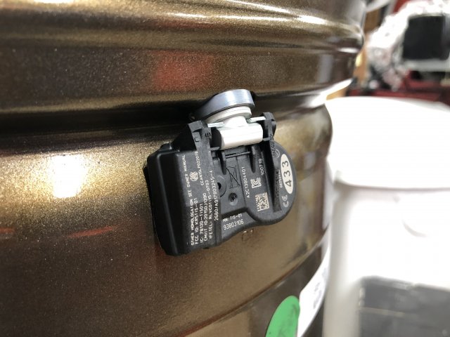

TPMS activation. Installed TPMS sensors in the new race stars, used units from summit that where supposed to be compatable with My 16 challenger. Mopar units, but car not picking them up, says SERVICE TIRE PRESSURE SYSTEM or something of that order in the dash display. These units the wrong units or just weren’t set up right when installed?
I knew I should have looked up the ones I bought and used in the 20x10.5 replicas in the spring and got the same ones BE2C14DC-FE77-454D-ACFB-660477FD8D00.jpeg image.jpg :(

Disconnect the battery for a few, then put some miles on the car.

I am not a big fan of battery disconnects. Besides I have never had to do that. All I can say is when a complete set of new sensors is installed it might take 20 minutes of driving to connect. So do 30 just to be sure. Once the car learns them they will connect sooner next time you switch them out. Car can learn and store 2 sets I think. Try hitting OK on the steering wheel. Go to tire shop and ask them to diagnose and wake them up. They have a device that will query the sensor. But the newer ones do not need to be woken up or reset. It's plug and play. But they can at least tell you if the batteries are dead etc.

Thread Starter #60
