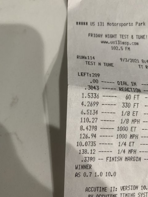

So on my normal tune at the track if I have a low 1.5 60ft at 137 or 138ish mph I am seeing 10.0 or a 10.1.

I will tell you last night at the same track I did 1.44 60ft at 2 months ago the best I could pull off was a 1.5. Prep wasn’t the greatest. I actually had wheel hop for the first time since the aad kit. @Phast Hemi told me to go up a pound and that seemed to help for the conditions given.
here is the time from a 2.85 pulley e85. I did have some stkr on this pass so I’m assuming that’s the issue for the et being only 9.90. But the 60ft was a 1.44

For reference. DA was around 2000 I think. I may have heard 2200
