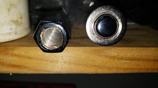

20200508_194041.jpg 20200508_193939.jpg They have to be shank but they are closed end. I figured if the track ever said something I would trim the end off. The washers are thicker and fit kn the Racestar lugs for your your reference. Here are pictures of them with the crao Racestar lugnuts. You can see how bad the centering is on the lugnut and the damage to the washers after 3 uses.
The crager or the gorilla work with the 1.38 shank length. P/N 84147
