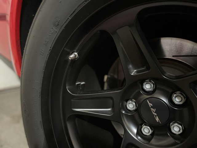

So you are saying you installed them wrong and they failed? Not sure how different the demon wheels are but I have them installed on my forgestar 18x6 and they fit fine
Like said they are not needed but it is nice not having the light on driving to and from the track. With the rears low at the track you still get the light there
Yes
Upside down or turned 180 degrees to get
them to fit.
They extended to far out passed the wheels
Edge or scrub line.
If they don’t fit correctly do not use them.
I just got rid of them all together front and rear.
I used the same valve stems that are in
The Demon crate
On all four wheels front runners
And rears. I do not trust that cylinder stem nut.
The light does not bother me I know why it’s
On.

I installed factory Tpms inverted (Not a good idea)
The tpms sensor nut came loose after crossing...
You really can't blame the sensor for what appears to be an improperly installed valve stem. And it sure doesn't help if also installing the sensor wrong on the valve stem.
Valve stems for TPMS can be used as regular valve stems. Just unscrew the sensor, or don't install it on the valve stem in the first place.
