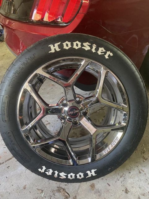

I've used 305 45 18 MT R's, 315 50 17 MT R's and finally the DBR in a 29.5x10.5x17. Wish I would have found them sooner... all my experience is on the street but I like them A LOT better. Even in the cold, with no burnout they hook on the street like crazy. If they hook this good on the street, i would assume they'd hook even better on the strip.

damn they look good too!!! Now that fills up the wheel well
