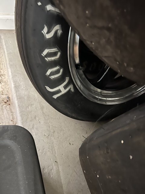

I have the forgestar d5s. 17 x 10 for the narrow body. And with the Hoosier radial slicks which are around 31 inches tall I do not get rubbing at the track. They are screwed to the rim. But when I get lazy after going to the track at 10pm and load the trunk up with 150-200 pounds of stuff they do rub. Maybe with a spacer they would not rub. I was thinking of running the Mickey Thompson radial front runners on the street which are six inches wide as compared to the 4 or 4.5 inch ones from the other manufacturers and a tall drag 17 inch radial on the back. Then no changing at the track. But I think someone told me the bead lock should not be run on the street. I can always not have them beadlocked.

These are sitting in my garage all deflated due to time. The last time I was at the track was the beginning of January. At a da of 4300 they were good enough for about a 1.37 60 foot and a 9.60.
