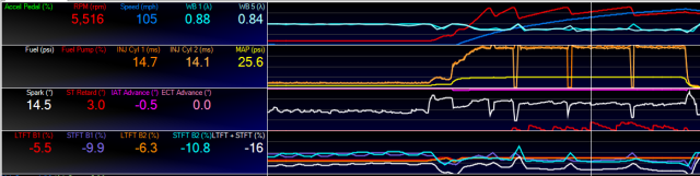

OH, and I found a log from my car bone stock. Starting IAT was 136 and at the top of the quarter 142. That was on 11 pounds of boost and an ambient temp close to 90.
I have tons of logs, if I got real motivated I'd plot them on a graph but honestly not worth the effort. I know what I need to know.
Edited: I also have my intercooler pump speed customized in my tune for best cooling at certain conditions, which helps with temps so that's another variable to consider as well.
Also, look at all the STKR in this log from my car BONE STOCK. No wonder the original motor let loose! I remember that in all my stock logs on 93 and is why I tell everybody never run hard on pump gas.
