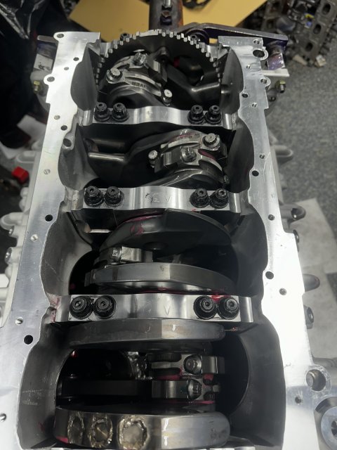

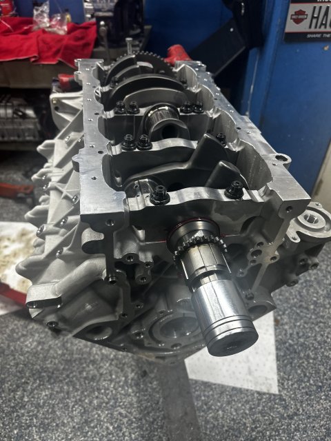

Christmas Morning time to do my shit.💩. Got my short block done not fun having to grind on a 7500 dollar block so rods clear cam tunnel. But it’s done

What does that wheelie woo down there drive?

The gear at the end of the crank?
That’s your reluctor wheel for crank sensor
29,534
130,953
Thanks. Does the sensor screw in through the block?

Thread Starter #136
You have to set a gap? How do you do that? Externally?
Just bolts in. Preset

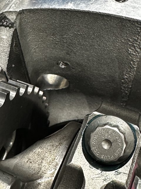

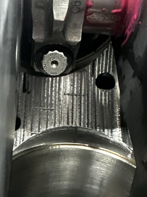

Looking good! Did you have to grind the bottom of the bores for the rods??

That’s crazy! Didnt have to take anything out of the sleeves though?
Nope.
29,534
130,953
It's not uncommon with custom bore and stroke combos or camshafts with cylinder heads.
