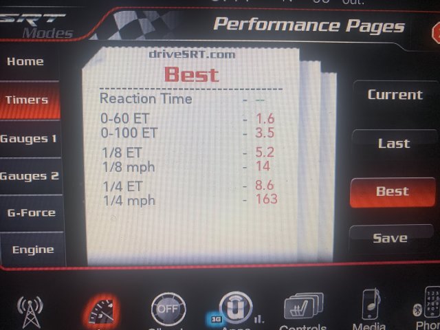

This is what my performance pages show. It’s actually pretty close.

Not as good as yours. They were 1.34x on my last three 8.6 passes. Not sure how many more my 2.62 rear will take, been through 4 years of racing on it.

Damn! Well if you ever get out to Arizona I have a 2.62 I’ll give you just to get it out of my garage.

You get that 1/8th mph up and look out!
I ran across your times online not long ago going 8.6, just awesome!
