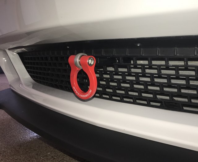

Some work for sure to install this tow hook!

All done. Ready for track!

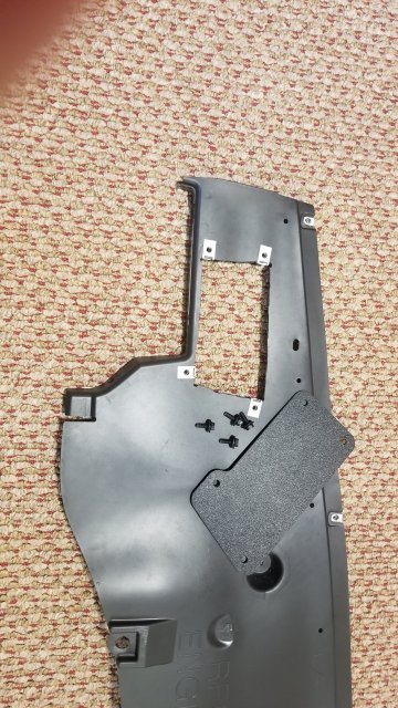

There was a guy selling a kit here awhile back that I installed. Much much easier to drain the oil cooler. 20190911_131409.jpg tapatalk_jpeg_1566876392578.jpg

There was a guy selling a kit here awhile back that I installed. Much much easier to drain the oil cooler. View attachment 37596 View attachment 37597
Yeah, I saw that, very nice, I did mine b4 he came out with this cover, the hole I made is rectangular also but only 1/4 the size of yours.
