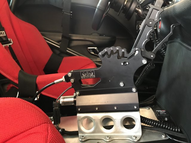

That’s correct if you have a standard valve body. But there are alternate valve bodies out there that have a “clean” neutral built in. Clean neutral reverse pattern valve bodies allow you to put it into neutral without causing it to overspin. It requires a shifter designed for this style of valve body. The shift pattern goes like this.
Park - Normal Neutral/Reverse - 1 - 2 - 3 - Clean Neutral
@Boris
A picture of what the shifter looks like for a reverse pattern safe neutral valve body.

These special race T400’s are not your old Chevy turbo hydromatic. Many of the clean neutral 400’s actually go into reverse by activating the transbrake while in the reverse position on the shifter. If you don’t do that it will damage the trans. Also you never start your burnout in first gear and shift to second. Second gear start only with one of these things. I have a completely different setup in mine. I have the valve body with no clean neutral. When I let off the gas in high gear, it immediately starts freewheeling and the rpm goes to idle. These things have about as much in common with that old factory 400 as the space shuttle. Mine… A3AFE9BE-8DEC-4B1C-AAE4-68FEB44E31C5.jpeg

My first time driving something like this I was 18 and was awfully confused by the whole reverse thing. I was driving through the parade and didn’t want to mess anything up I ended up telling them I didn’t have reverse 🤣

You have a passenger seat
