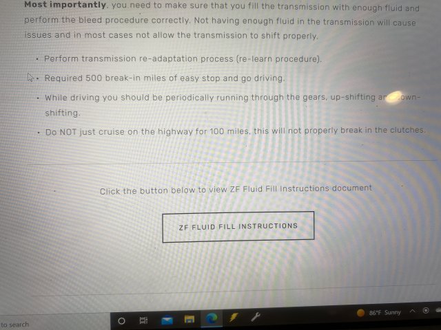

So I think I am out of my element here. Last night we installed my Pure transmission. We got it all buttoned up, did the fill procedure and got it ready for driving. We are following the guidance here:
https://www.puredrivetrainsolutions.com/break-in-process

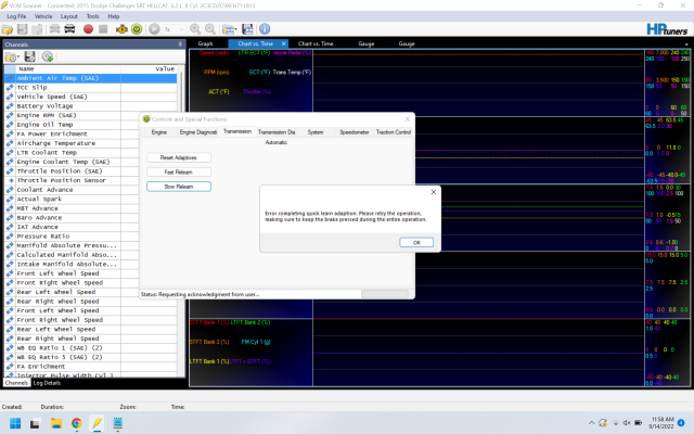

Mike's Wi-Tech couldn't locate a relearn procedure to run. We switched over to HP Tuners. Cleared all TCM and PCM DTCs. Reset all adaptives and then did the Fast Relearn procedure. Mike said it went through all the gears. Drove it home and it went into limp mode. Would not get out of sixth gear. Stopped in a parking lot let the car reset after turning it off. Went into limp again and got it home. Today, reset all adaptives, reset all the DTCs and attempted to do the Slow Relearn this time. HP Tuners gave me this error:
Attempted to do the Fast Relearn and nothing, same error.
Reset everything again and just put into reverse, backed it out of the garage and drove it. Went right into limp mode again. I'm kind of at my wits end with this car. I don't know what to do and I can't put any more money into it. I have reached out to Pure and hopefully they will get back to me soon. But if anyone has advice please don't hesitate to chime in. Tune, log and error codes are attached.

they are attached in the text file:
0x7E8: P0430 - Catalyst System Efficiency Below Threshold (Bank 2) (Permanent)
0x7E8: P1206 (SES, Pending, Current, Permanent)
0x7E8: P2096 - Post Catalyst Fuel Trim Sys Too Lean Bank1 (Pending, Permanent)
0x7E8: P2098 - Post Catalyst Fuel Trim Sys Too Lean Bank2 (Pending, Permanent)
0x7E8: U0140 - Lost Communication With Body Control Module (Permanent)
0x7E9: P0716 - Turbine/Input Shaft Speed Sensor A Circuit Range/Performance (SES, Pending, Current)
0x7E9: P0732 - Gear 2 Incorrect Ratio (SES, Current)
0x7E9: P1D90 (SES, Pending, Current, Permanent)
0x7E9: P1D95 (Permanent)
0x7E9: P1DF3 (Permanent)
0x7E9: U0001 - High Speed CAN Communication Bus (Permanent)
Freeze Frame: 0
DTC: P0732 - Gear 2 Incorrect Ratio
Calculated Engine Load: 12.5490196078431 %
Engine Coolant Temp: 88 °C
Engine RPM: 3496 rpm
Vehicle Speed: 40 km/h
Control Module Voltage: 13 V
Accelerator Position D: 19.6078431372549 %
Freeze Frame: 0
DTC: P2098 - Post Catalyst Fuel Trim System Too Lean Bank 2
Fuel System Status: 02 02
Calculated Engine Load: 22.3529411764706 %
Engine Coolant Temp: 83 °C
Short Term Fuel Trim Bank 1: -5.46875 %
Long Term Fuel Trim Bank 1: 0 %
Short Term Fuel Trim Bank 2: -1.5625 %
Long Term Fuel Trim Bank 2: -1.5625 %
Fuel Pressure: 453.000472515733 kPa
Intake Manifold Absolute Pressure: 40 kPa
Engine RPM: 699 rpm
Vehicle Speed: 2 km/h
Timing Advance: 8 °
Intake Air Temp: 53 °C
Throttle Position: 11.3725490196078 %
Run Time Since Engine Start: 124 s
Commanded EVAP Purge: 8.23529411764706 %
Fuel Level Input: 46.6666666666667 %
EVAP System Vapor Pressure: 15937 kPa
Barometric Pressure: 101 kPa
Absolute Load: 22.7450980392157 %
Commanded EQ Ratio: 1
Relative Throttle Position: 1.96078431372549 %
Ambient Air Temp: 38 °C
Absolute Throttle Position B: 11.7647058823529 %
Accelerator Position D: 8.23529411764706 %
Accelerator Position E: 4.31372549019608 %
Commanded Throttle Actuator: 1.96078431372549 %
Fuel Type: 01
68: 07 5B 60 5F 00 00 00
77: 0A 00 5D 00 5E

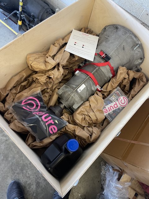

Spoke with pure again today, was told there were two, one ounce quarts and the two gallon container. Evidence A: crate opened upon delivery.
notice no two additional quarts.

Curious how many qts did you put in it
The 2.5 gallons provided which would be ten quarts. Mike did the fill procedure to Mopar specs. Heat it up, open the fill cap, if its flowing out it is good if it isn’t then more fluid required.

Only 8 quarts was put in? That seems... short by a lot if the trans was completely empty. Invalid question, striking out.
Were similar procedures followed when fluid level was checked? See attached.
4,117
10,340
Thread Starter #20
2.5 Gallons is 10 quarts? Is my math wrong?
