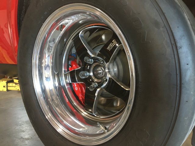

Do the rear wheels have knurled beads? Are you worried about the tires turning on the wheel?
HRJ
HRJ
#1045
478
1,043
Porsche GT3
Thread Starter #69
No knurles. Yeah, they’ll spin on the wheel but they don’t weigh near as much as a beadlock. I can have the tires moved back pretty easy here at work.

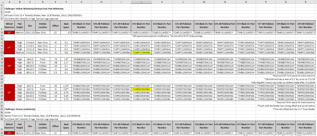

Random question, I’m looking to order those rear wheels. But when I’m on the weld website I’m seeing 17x11 6.2 vs 5.8, I’m trying to figure out what that is. Which option did you run? I’m looking for that exact look in the rear that you have!
10,672
30,163
#75
Welcome to the site.
Lots of very knowledgeable people here.
An old post, but someone should have your answer.
Under-Pressure
#20108
732
2,306
Space Coast
Stellantis 2dr
#76
5.8 was the backspace used on the OP’s car.
