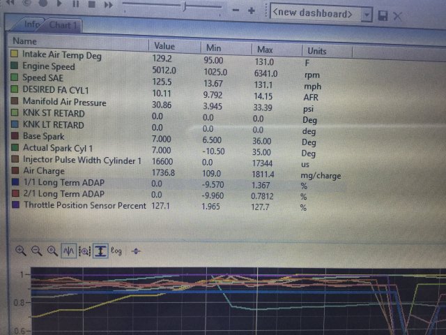

Tell me more about why not to run the 3.17. Post your datalog and the info to support it. Here is a data log from my redeye with the incognito. Just snap shot of the highs and lows. I want learn but I see nothing wrong. image.jpg

What was the DA air? And what is your elevation? About 17lbs boost?

55 outside around 200 elevation. I have some logs when it was -1100 da also. 17psi around 5500 rpm if I remember correctly.

Not sure if you mentioned what octane fuel you are running? Steven Ripa said 93 octane is needed for the Redeye/Demon, but 91 works just fine for a Hellcat/Trawkhawk with the incognito. I talked to Paul Georges (I think he works with Litens). He said he's seen no more than 1 degree of timing retard with the 3.17 on his Demon and Redeye during testing. I told him others seemed to have different results with the 3.17 pulley. He said 93 octane is required for that pulley. It's supposed to pick up about 50rwhp on the Redeye and 65rwhp with HO mode.
Personally I don't trust any added pulley without a tune for it. That and can the incognito's extra mass to the stock pulley cause an imbalance issue? I like that the Litens one is at least a decoupler style (same as stock).
So your logs are showing no knock issues, if I am reading that right? Both the 3.17 and incognito add about the same amount of boost. You'd think they'd both have about the same results.......

Yeah zero knock but I run 93.

I'm also interested on that pulley too! If you could add one more channel in your data reading, I would suggest "fuel pump duty cycle %". It could be also reassuring to see it. Thanks.
