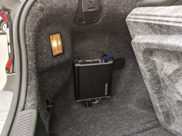

Longer term update:
I have been very happy with this install. I've got probably 10 hours or so in the car with this JL sub and have had no issues. No cooling problems so far with two hour stretches of moderate bass play. I've dialed my input sensitivity down to about 50% for nice bass but not overpowering amounts. I can now enjoy listening to music! Sounds like it should and much more like I would have expected from a nearly $2k upgraded audio option. Plenty of bass gets through to my ears so I don't plan on cutting holes in the tire well cover or removing the unused factory woofer in the center of the parcel shelf. Bass is just how I like it, clean and tight with no distortion. No rattles from the car and not overpowering. If you want more bass, it can do a lot more, its just a quick adjustment to the input sensitivity. I'm also happy that the head unit equalizer bass slider does have a decent effect on the subs output. So you can get a bit more or a bit less bass easily while driving.
Your install looks very clean and I would be interested in copying it. Quick question. Is your amp under the speaker box? If so would it be possible to get a pic of the inside of our foam tire well without speaker box? Any help would greatly be appreciated!

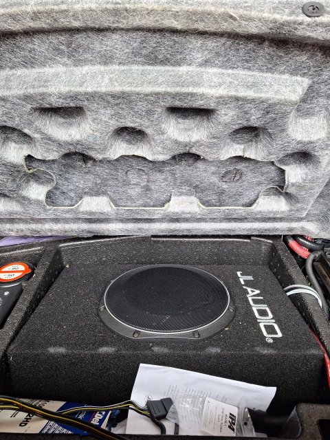

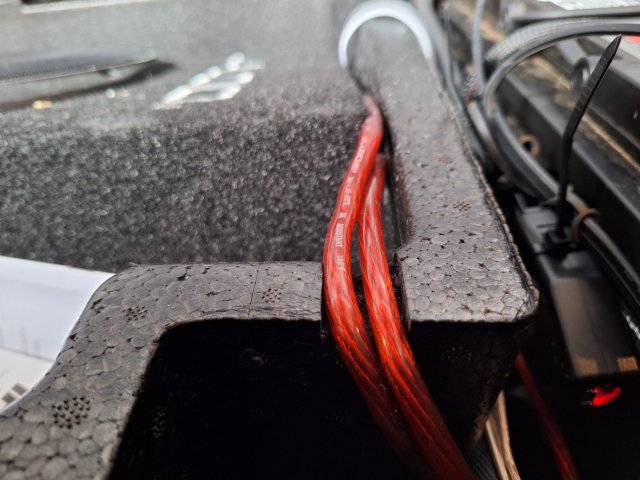

@Scatpack2023 I cannot speak to the difference in trunk trays between your car and my charger. I do know that I elected not to trim the tray at all and instead cut a recess into the lid that fits down over the spare tire area. I only notched one edge of the foam low enough for the wires to pass over and down into the box.
It looks like after 5 years give or take that I could have actually extended that cut about another quarter inch or so toward the rear bumper as you can just begin to see the depressions on the carpet of the box.
Also... looks like i dented the speaker Grill at some point. I don't know if that is from the edge of the cut or if it's from me ham fisting it like a potato. Another quarter inch in both directions from my cut and it probably would have never made contact if that's the case
View attachment 136491 View attachment 136492
Hello fubar569,
Thanks for the extra pictures and clarification! Five years use and still going well says alot for the JL Audio self powered subs reliability and issue less function in this application.
From everything I've seen, the same part number foam liner is used in all models Challenger, Charger and Chrysler 300. The number has superceeded several times but I don't know if there are any real or slight differences between any of the different number foam liners.
Studying the pictures from AV8ing1 posts and me test fitting this sub into my foam liner, it really seems that some of the lower floor of the foam must have been removed or cut out in an area completely to allow the sub to sit in the foam that deep. I do like the way he cut the hole in the side of the foam for the wires and to allow adjustments.
Wishing for a response from AV8ing1 to confirm foam liner modification before we begin cutting on it.

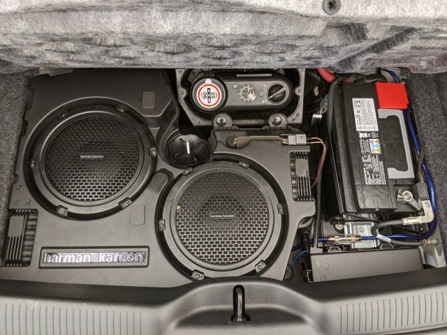

Another option is to find a slightly used Harmon sub box from another Challenger and an amp. Keeps it hidden and provides good bass from what I can only describe as baby sized magnets. About 4 years in and still sounds great. Many thanks to Diboblo again for his expertise!

Taxinator, Hello,
Yeah that Harman Kardon dual 10 box is an ultimate clean OEM set up and thats actually the direction I started to head with until recently the companies who have really nice used HK units want an arm and leg in $$ for them now. You combine that price, an amp etc and then if you ended up having to upgrade the speakers as these now older units come without any warranty and the price point is on up there. I priced a new one and with shipping and tax you'd be at around $900 plus and also the amp cost. The JL Audio ACS110LG-TW1 with built in 400 watt amp, two year warranty and good review changed my mind.
Hopefully will have it installed and up and running soon. Once complete and tuned I'll post pictures and my evaluation for you guys. Thanks again for all the input!
