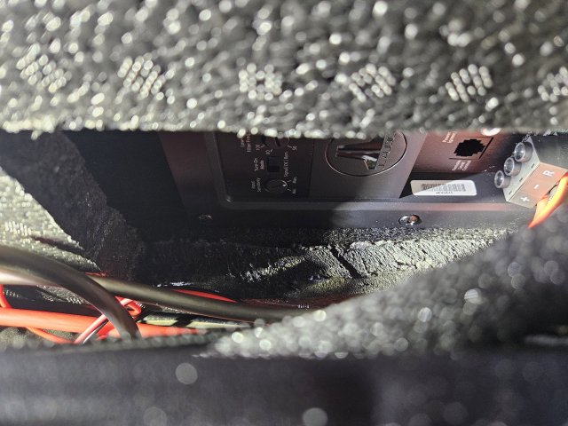

I realize this is a almost four year old post but I am ready to do this same install with the JL Audio ACS110LG-TW1 in my 2023 Challenger Scat Pack with Alpine 10 speaker system. It's seemingly a very similar issue as the Charger HK set up with the 8 inch sub in rear deck that just doesn't do it for bass.
Question I have is the JL fits really tight in the Styrofoam liner. I noticed they all superceed to 05030175AF but this latest looks slightly different than your pictures. I still think it's doable but could use some advice on the amounts and locations you shaved, cut, deleted the foam in your install to obtain that below level clearance would be very much appreciated.
So sorry for the slow response. Its been awhile but as I recall I did not go all the way through the foam. Its paper thin though at the back. I figured if and when I sold the car I would just get a new foam insert for it. Never looked into the availability or cost of that though. IMG_0641.JPG

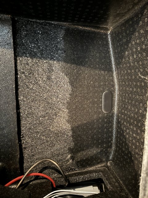

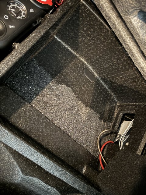

So sorry for the slow response. Its been awhile but as I recall I did not go all the way through the foam. Its paper thin though at the back. I figured if and when I sold the car I would just get a new foam insert for it. Never looked into the availability or cost of that though. View attachment 138916
Av8ing1,
Hello and thanks for responding and with pictures!
We have mine completed and installed. Where your foam is paper thin, mine was just completely cut out. Still plenty of material left to maintain the integrity of the foam liner and the JL sub fits down in there at about the same level all the way around. The passenger side has an area cut out like yours to access all of the adjustments and plug ins. The foam and sub can easily be removed and installed together as an assembly. The sub sounds great and provides the adequate bass the 10 speaker Alpine system in the Challenger was missing.
I'll post some pictures soon.

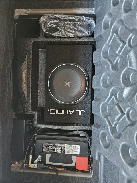

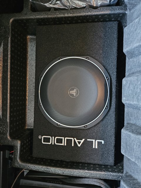

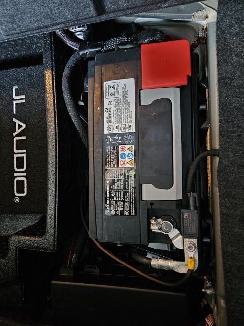

Here are some pics for everyone to see. I really like how clean this looks and performs without any loss of trunk space.

I'd like to also add, I have a premium WeatherTech trunk floor liner from my previous Challenger. In the previous Challenger with the HK OEM trunk floor sub I noticed no reduction of bass into the cabin with the WT trunk floor liner installed. Same goes for this JL Audio sub in the trunk floor foam insert, no noticable loss of bass performance with the WT trunk floor liner installed.

#73
Looks nice and clean!
