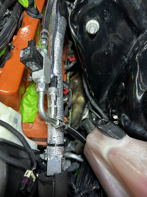

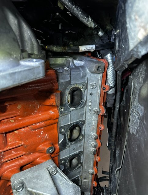

Passenger side completely out. 2 bolts left on driver side. Going to be a pain due to my chiller refrigerant lines

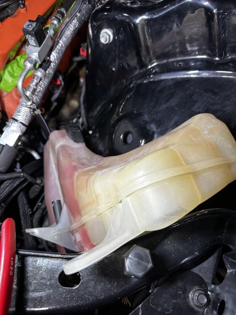

Still a pita with chiller lines, but not much worst that stock. This gives you a lot more room (still a pitta)

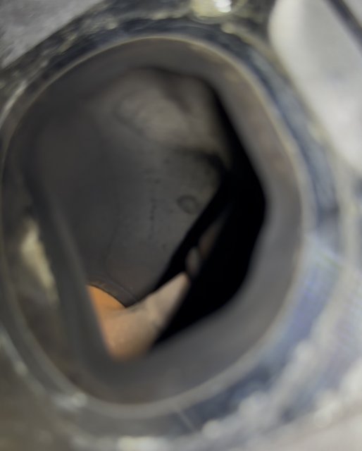

Ports could be worse. Tops of the valves are orange.

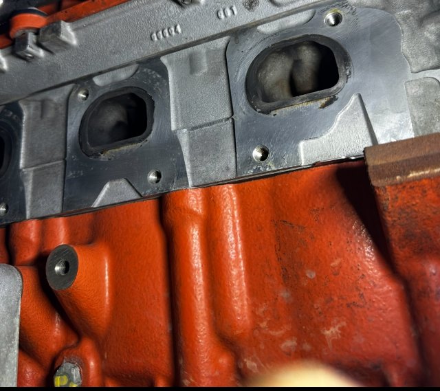

really nothing to clean off of the heads. Suggestions? Brake cleaner and a cloth?
3,933
9,717
#92
Red scotch brite or snapon cleaning wheel.

Welp slow and extremely light and scorch brite left small scratches in the mating surface in the heads. A bit weary since it’s a metal to metal seal

Might need a light coat of RTV to make sure it seals.

I’m getting it off but I don’t want to keep going over it, especially since I can only go over pretty much 1 at a time. Don’t to create low spots. I have more off now than in this pic in those 2. I think rtf might lead to more problems, not sure 🤔

Any amount of leaking can cause the computer to think it's running lean when it's not because it can pull in air--a vacuum leak upstream of the catalytics.
