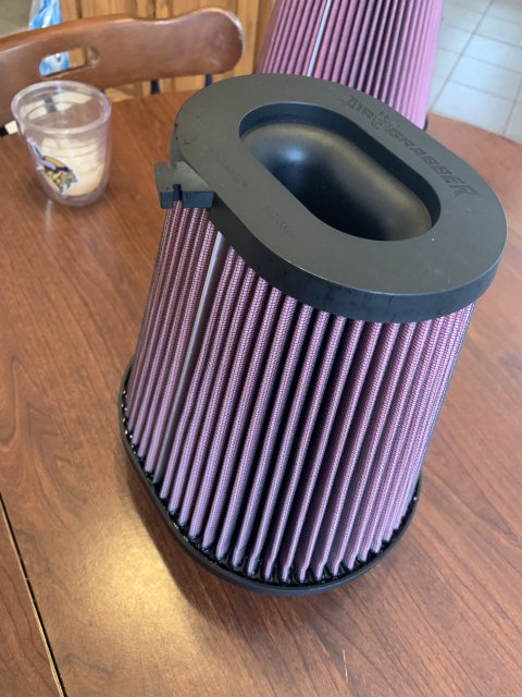

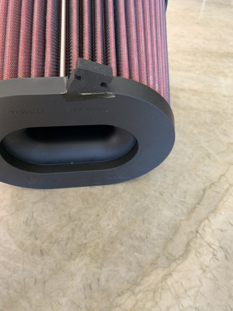

I am happy. Just got it today. I’ll put it in and run it down at Hallett in two weeks. Hope it screams even louder. For $65 the only defect was the tab was broken. After a bit of glue, it may be better than the original!

Well that looks pretty good David, good repair! Will be interested to hear how easy you think it is to swap the filter out. I'm hoping mine comes in Monday :)

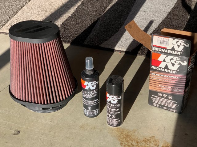

I wanted to reuse them because this is just a grown up version of the high performance cone air filter some of us motorcycle nuts have seen for about 20 years now from K&N, no doubt. Mine screwed on the big 124 ci the same way, got it on my HD in the garage still. So with that extra unit I won't need any more air cleaners forever for this one! If you guys have not already figured it out, go out and get this kit I picture below to maintain these great units. You guys think I can get the 11 hp back now?:rolleyes: But, not giving up #797!

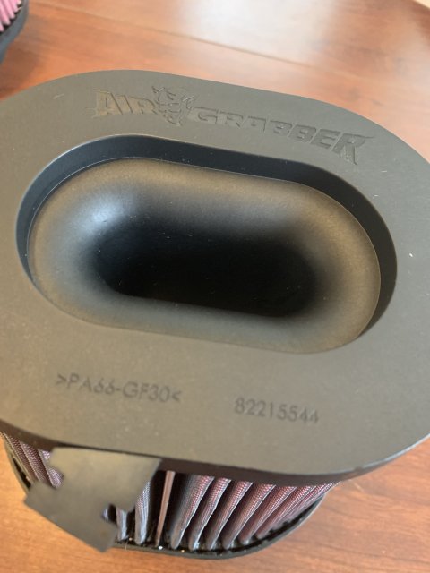

I ended up getting two of them at $65, because I couldn't quite tell from their pictures how they were damaged. I ended up installing one that has very very slight bends in filter fins. The other one I got is perfect, minus that tab that broke off (just like yours). So I'm going to either epoxy or superglue it back on. I can see how it can snap off. Dodge should have mounted that tab on better. There isn't much that holds it on.

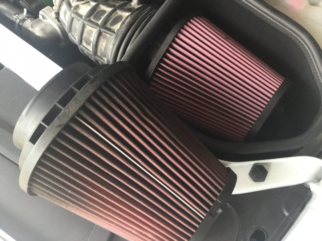

Not sure how anyone else installed their filter, but I just took the 3 torx screws out with the intake still in the car and removed the filter + loosened the clamp to filter. It was kind of a pain to remove those screws, the rubber intake ribs were in my way a good deal, and the screws were in awfully tight imo. Next time I'm wondering if it might be easier to just take the entire intake off, then remove the filter. I also might grab an extra set of those screws, just in case my other ones start getting a bit stripped over time.
Lastly I looked at both Redeye factory filter and this Demon "race" filter and I don't really see much if any difference. I thought maybe there was a hole in the demon center for extra flow, but it's just a fake hole that goes no where lol. Seemed like daylight went threw both filters to me about the same. Once I drive it I'll have to see if I can feel that 11hp, hahaha!
I agree on finding a difference even in the mesh and gauze. The flow diverter may help some but the filter does look cooler. I did a bunch of light tests and just couldn’t find any other difference after my redeye filter was clean. It’s hard to tell if the redeye has 2 or 3 layers of cotton gauze and of the demon filter only has 1. That’s the typical “race filter” design with airaid stating there single is the highest flowing filtering filter. I need to mic out the filter to see if the mesh is thicker between the two.
