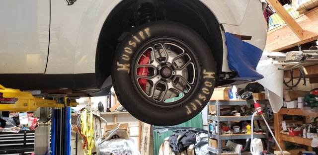

I bought the wheels used but a quick tape measure/straight edge measurement shows to be 6"b.s. They fit well, no clearance issues anywhere and the 315/50 fits the 11" wheel width nicely.
I got my skinnies on recently. I went with the Forgestar D5. They don't seem to be as far sunk in as many of the other skinnies I've seen. Also, they clear the big brakes the RE has. And once they're powdercoated they look good w the S71's.

Damn that car looks good
