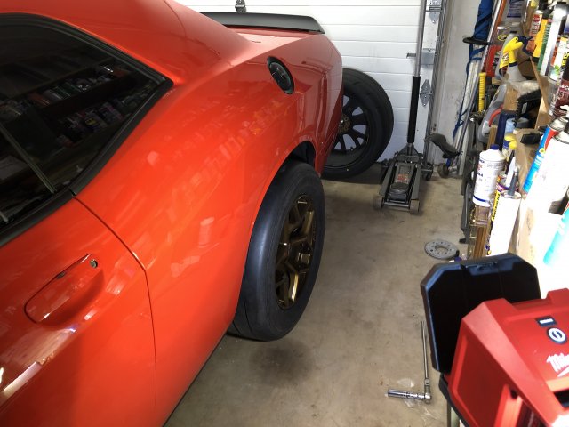

I bought the wheels used but a quick tape measure/straight edge measurement shows to be 6"b.s. They fit well, no clearance issues anywhere and the 315/50 fits the 11" wheel width nicely.
I got my skinnies on recently. I went with the Forgestar D5. They don't seem to be as far sunk in as many of the other skinnies I've seen. Also, they clear the big brakes the RE has. And once they're powdercoated they look good w the S71's.

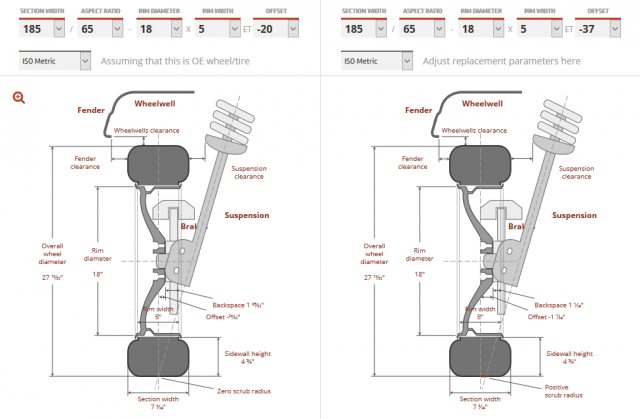

For those who cannot visualize the difference between a Racestar with -20 offset and these Forgestars with -37 offset... here you go:
I am too blind/stupid too decipher this info.
So, what does this mean?
-20 or -37 offset?
Which is better?

0 offset is the middle of the wheel exactly so a negative offset moves the mounting pad centreline toward the inner portion of the wheel barrel, and a positive offset toward the outside. Arguably a 0 offset is best as it even aligns the wheel over the hub centre and manages mechanical loading best, this is without getting into things like scrub radius and leverage issues associated with working angles.
I'm old and old school. I still love the "deep dish" look on muscle cars. Took me a long time to get used to the positive offset on newer cars. Just looked goofy to me. Unfortunately with the big brakes and offsets you can't get that look on the Challengers.....unless you get the widebody.
