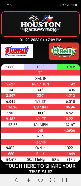

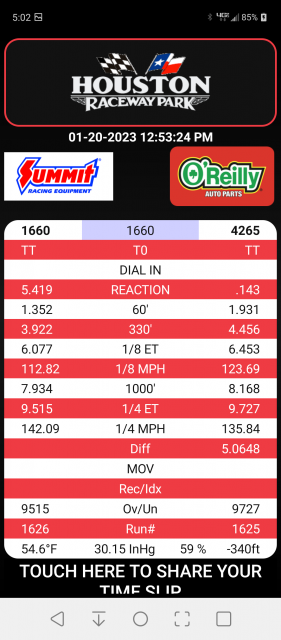

OK, Brian Mason's event went off. Some sprinkles and then about 15 minutes of rain but it eventually stopped and they dried the track and we got going. The track personel are some really great Guys. They did a great Job.
I like these taller tires. I think they showed potential in possibly going a little quicker if the conditions were better. I ran a 9.48 and the conditions were not all that great. It was the second pass. They used me as the initial tester. No body wanted to run first because of the rain, so I sent it. No time slip of course. So, fully warmed up and I did not have to wait too long but I could not loop right around into the bleach box either. Would not have mattered much because the power chiller was not enabled. This car is stingy with the chiller and it's so frustrating. There is very likely .02 in the sixty and more than that in the final numbers. But 9.48 without it @ 142. Dang, I'll take that. Last weekend the 9.46, 47 and 48 ALL had the power chiller on. So I likely would have matched the PB in worse DA. But I had to abort a couple runs because of the Hoosier Death Wobble. This set is the worst. The first runs did not do it. It defies logic. This set even did it a lot at Irwindale and that is rare to do it in the 1/8th. Anyhow, ran 142 a few times today without the chiller. In fact it never got warm enough for it to come on. 9.48 MASON.png 9.51 MASON.png

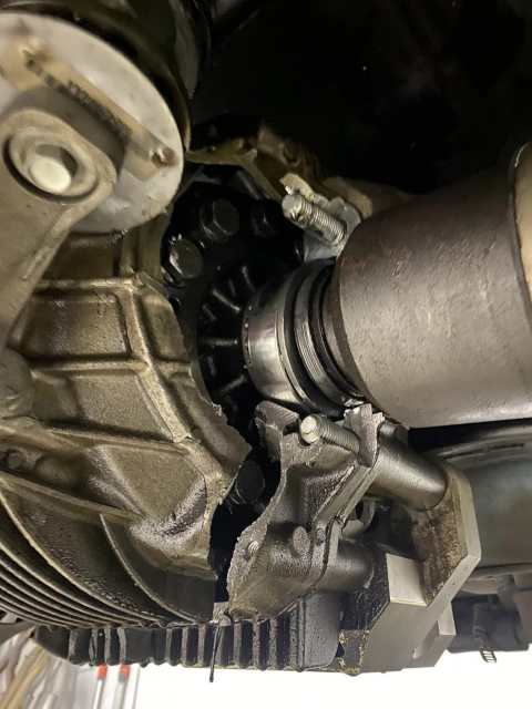

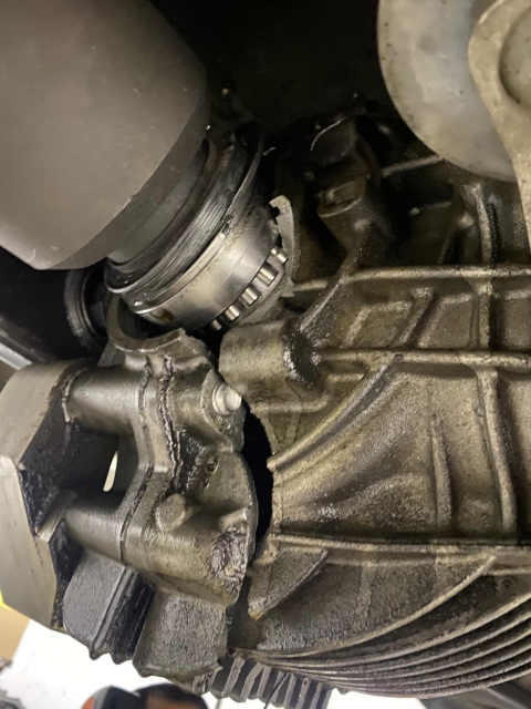

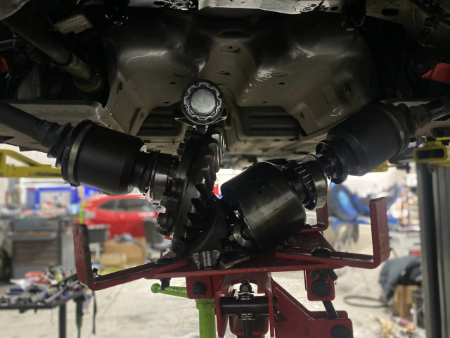

Did any rear diff housings let go this year at
Legion?
60,217
209,942
Legion?
Yes. Sumit Goyal split his in half. Saw pics the other day
