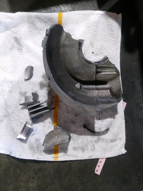

I know you hurt some diff's with the Demon. Did you tear the ears off any of them like with your SS?
One ruined the bias and started one legging and another busted on the hit also on 808 mode (VS the SS on 807). The one on the Demon that busted seemed to do it more from spreading the case apart. The SS absolutely broke the ears off and never leaked one drop of oil.

I always attributed those case explosions to the Demon case heat treat. It seems to me that they clearly passed the point where harder = stronger and clearly got into the too hard = brittle point.
IMO, the ears breaking off is just poor engineering. Thus the reason the P4D makes sense..
This all reminds me that the diff in my '19 is an actual Demon unit and has a lot of runs on it by now. I may need to do something about that before I run it anymore.
