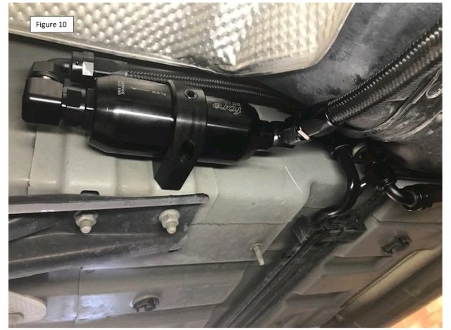

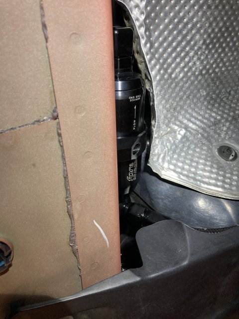

Where is it supposed to be installed? Like under the car? In the engine compartment etc.

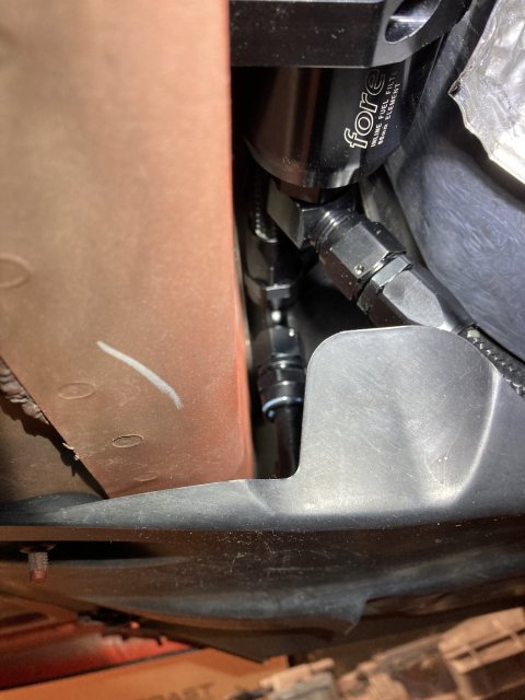

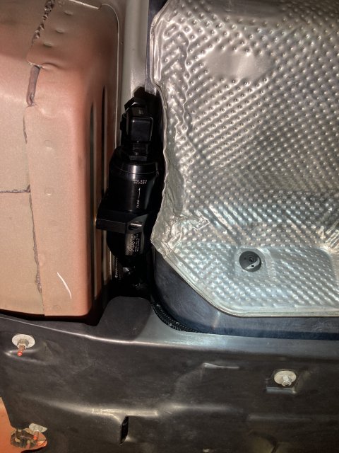

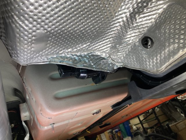

I’ll post some pictures in a bit be patient, I looked for them this morning for 20 minutes I have 25,000 pictures on my phone wait till I get to work and I could screw off on their time lol
Under the car somewhere near the fuel tanks.

Not invasive at all, sorry to take so long, busy day at work today with real work I’m paid to do lol
Hope you guys can make heads and tails out of these pics.

All the bends gave me some concern....probably fine based on the fuel pressure but still bothered me.
