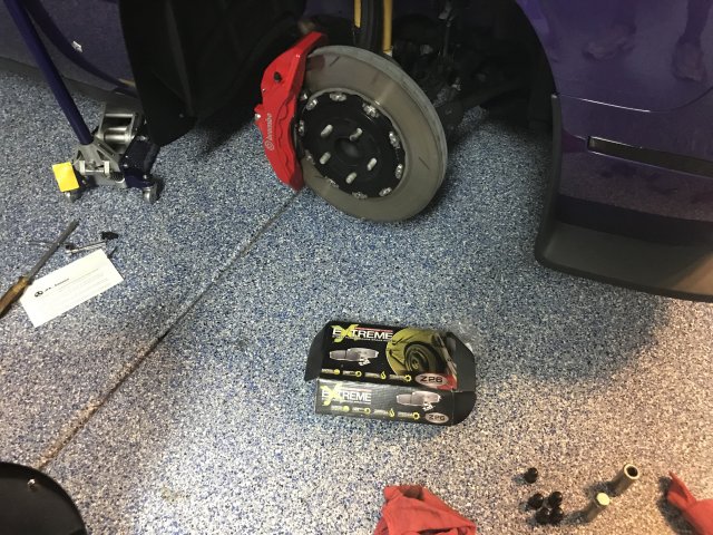

After only 300 miles I could not take the dust anymore. Yes all 4 corners. 8EE334A0-9938-49D4-AE90-1A0B2D1966A5.jpeg

Just got all the Z26 pads installed yesterday, and of course it decided to rain today so I still need to do the "bedding" procedure.
Just like everyone said, it took way longer to get the car jacked up, clean up the caliper and wheels than it took to install the pads. I got an extra set of hardware for my front pads in the box...not sure why - guess it was a mistake from Powerstop since pins and spring plates in both packs were identical. The instruction sheet they provide isn't for Brembo style calipers at all...
When I took the OEM brake pads out, the only lube I saw on anything was a light film on the back of each brake pad, so I used the provided silicon lube by Powerstop and did the same prior to installing the Z26's. Everything else was bone dry...all the pins and plates.
The OEM Bembo pads still looked like new after I removed them, so I marked each set as to which caliper they were in and put them on the shelf.
